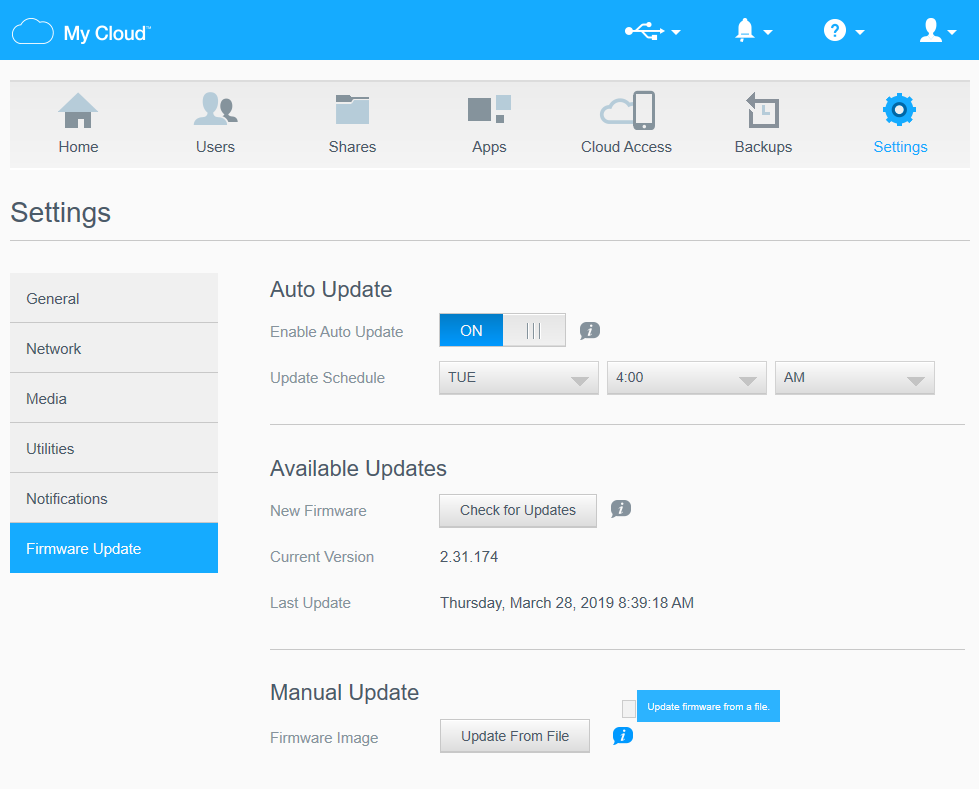

This post is to all new users having trouble with updating firmware or may need this in the future.
When a notice is given about new firmware being available for download you should download it and I suggest placing it on your desktop so it is easy to find. After this go to the Dashboard>Settings>Firmware Update>Manual Update and click on the button Update From File. This will be the file you downloaded. You should not have any problems. See example image below. Click on, tap or activate image to enlarge it.
See this article for more information.
