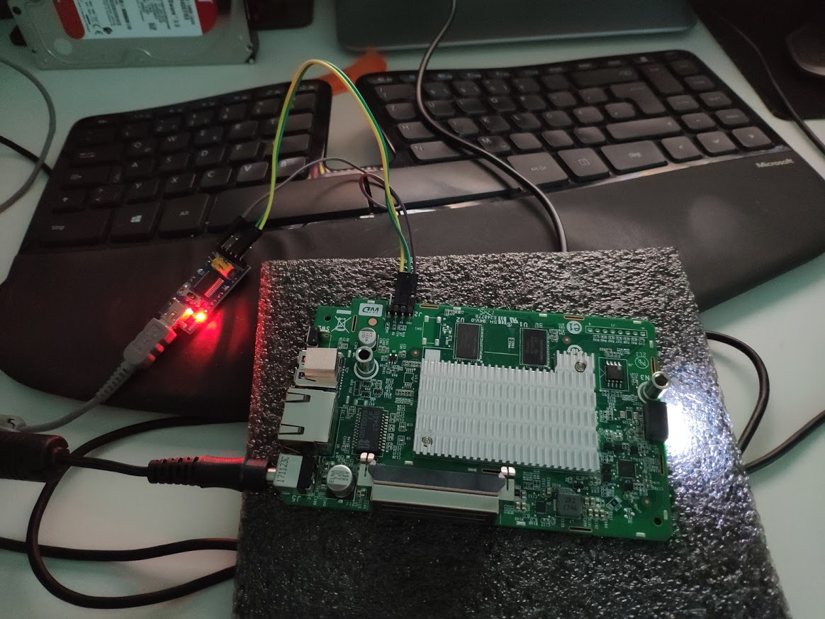

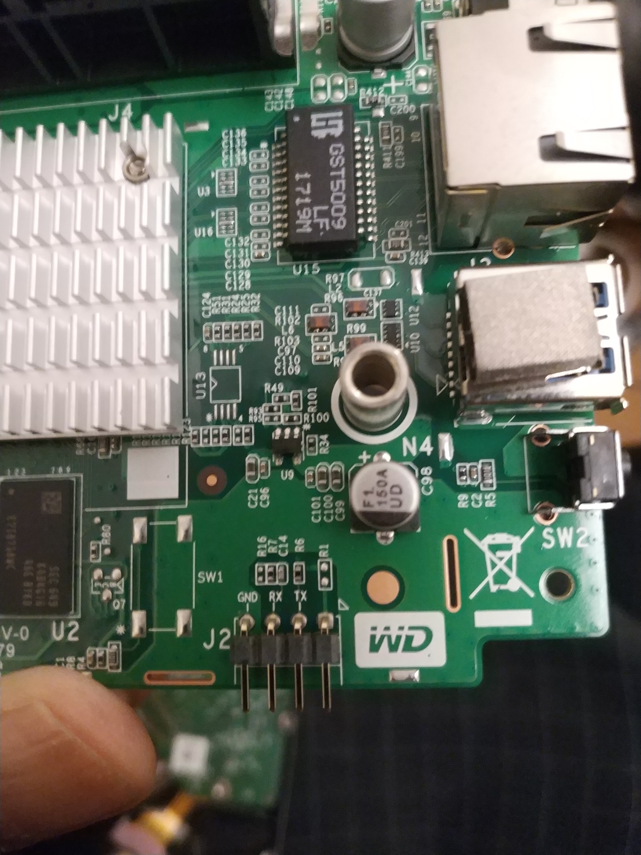

also 4pin uart is present but when i was poking it it was behaving in weird way. system would not boot if ground was connected and was not outputing anything with only rx and tx connected.
only when powered for a second i had to plug gnd and then i got some garbage on terminal (most likely incorrect settings on my side).

You need uart adapter to stop the system from booting.
Anyway, it’s useless, there is no kernel for the realtek cpu.
