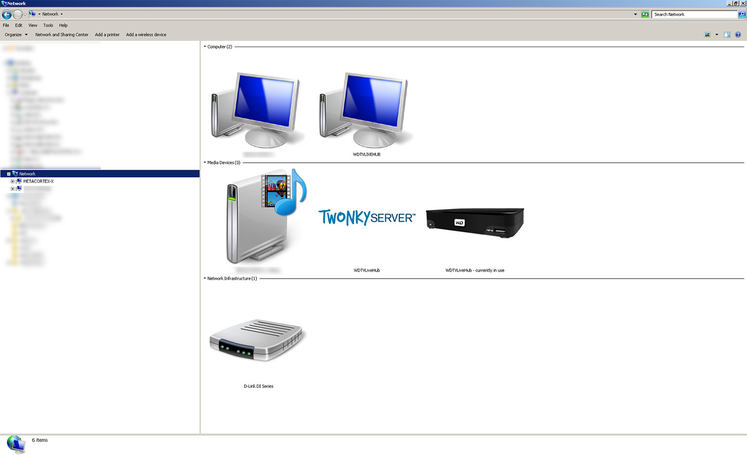

Use your PC,
go to Network and see if there is an WDTVLiveHub with TwonkySerever icon listed under the MediaDevices list.
If there is, right click on it View Devics Web Page.
You can see if it is shareing anything. Also you can set what would you like to be shared.

Thanks for the pic. I can now see that I only have the Tonky Server for my NAS, but not my WD Live Hub. My Live Hub is only listed under “Computer’’ and not under “Media Devices””?

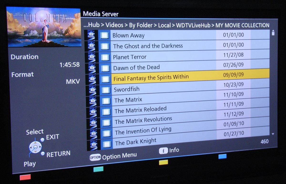

My Panasonic Smart TV see’s my WDTV Live Hub (via DLNA and the Panasonic’s “Media Server”) without any probs ?
It’s “Wired” … maybe try running the Panasonic TV Network Setup again ?

Actually on one PC on my network its not listed at all as Media Device, but on another PC it’s listed as 'WDTVLiveHub - currently in use", but not “TwonkeyMedia[NAS]” as my NAS drive is listed?

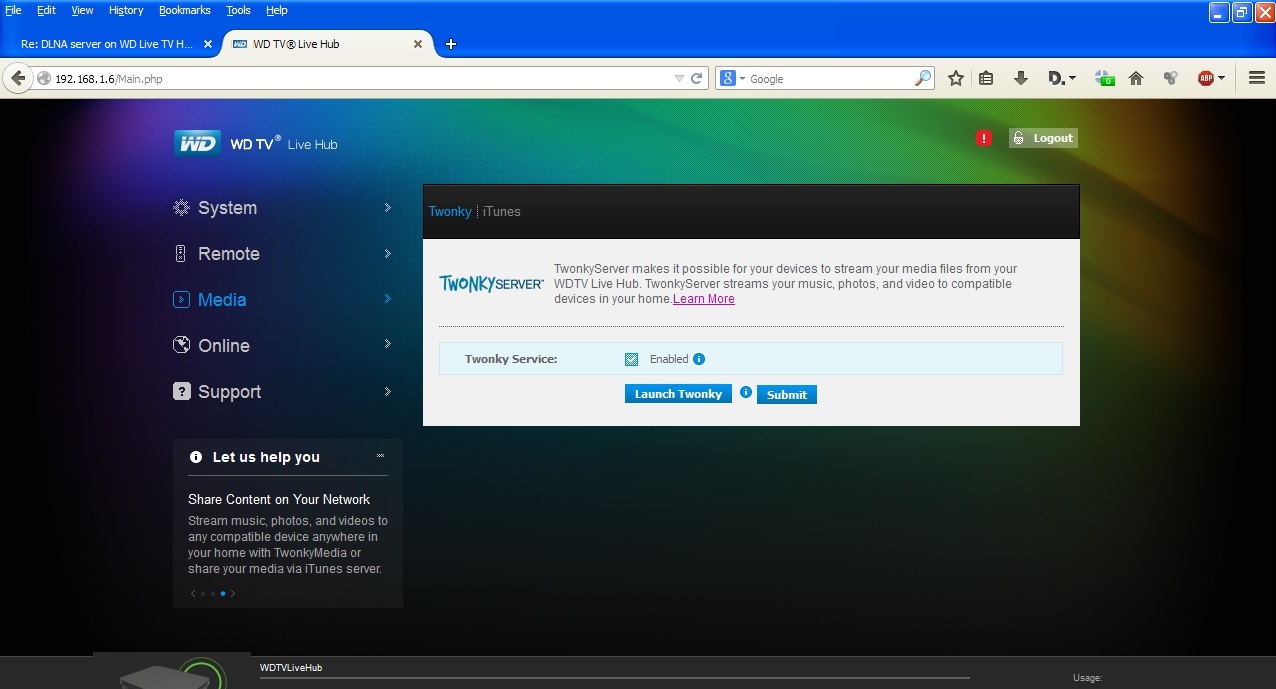

Double click on “currently in use” icon. It will take you to WD Hub web page, password is admin. Under the Media, check if Twonky is enabled.
Have you checked Twonky Server is Enabled in the WEB UI ?
On the WDTV Live Hub press … Setup > About > Network Info > 192.168.XX.XX
copy and paste the IP number into your PC web browser (password/login = admin) and check Twonky is “Enabled”
(use Firefox or Chrome Browser)
Thanks again. I followed those steps and found that Twonky was already enabled? Cheers

Did you tried to Lunch Twonky (button is under enable) from hub web UI
Yes, I forgot to mention that I tried clicking ‘Launch Twonky’ and received an “Unable to Connect - Firefox can’t establish a connection to the server at 192.168.1.11:9000.”
