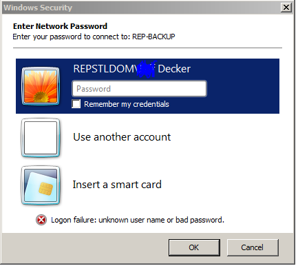

I reset the password, and this is what I get when I try and login. But I still can’t login, any ideas?
try removing the domain or changing it to Workgroup.  to remove the domain, type   before the username.
You must provide what it is asking for, your network password, not a My Cloud password. Do that and you should be able to get to your My Cloud.

Cat0w, there’s no possible way a router password has anything to do with network shares. It is asking for the user / password set on the Cloud.
Reply to: TonyPh12345,
You are telling me I don’t know what worked on my computer!!!
Look at the image that was provided!!!
Your username should be entered like
[Your_NAS_as_it_appears_in_Network_Neighbourhood][Your_user_name]
Note the "" between both
If that doesn’t work with the current password, make sure you have not other current connection to the NAS with a different username.
With a command prompt, you can type “net use * /delete”. This command will show you all connections it would delete if there is any. Then try again.

I’ve tried changing user name and password and this is what I get.
That error occurs because you’ve already logged into your NAS using a different user name.
Windows doesn’t allow that (and it’s the ONLY operating system with such a limitation.)
See Etupes’ post on how to clear the cached connections.
The syntax is
net use * /delete
(not user which was probbly a typo.)
Thanks Tony,
I had just figured it out before you posted. I had mapped to a folder on the NAS before I had created the test folder. Removing the mapped drive solved the problem.
