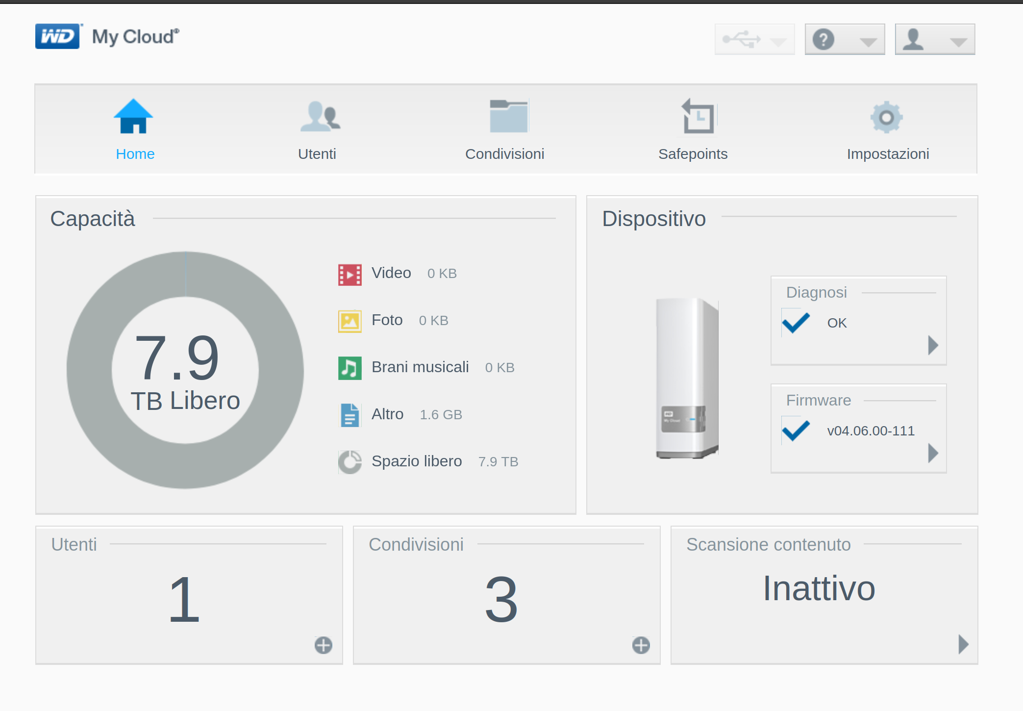

So, I’ve mounted a new HDD WD RED 8GB on that WDMyCloud Gen1, and now all stuffs are OK.
Then I have also upload a new firmware, v04.06.00-111 and now this is the result of lsblk command:

RAID partitions are different from that ones I prepared and cloned with previous firmware v03.04.01-230
Do you think this system is now reliable for a SOHO use? Obviously with cloud features disable for security reason.
