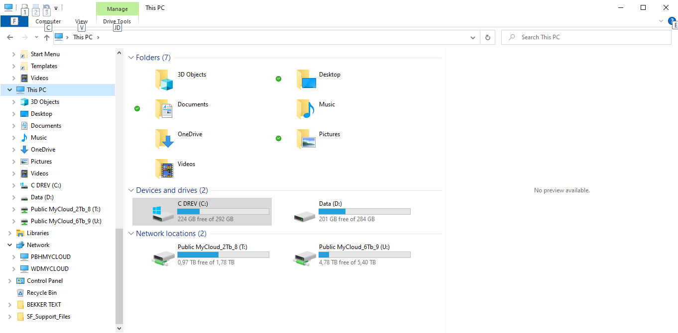

I right clicked This PC and clicked Map Network Drive and browse and could select my WD drives where I chose the Public folder and now they just look like a normal disk.
The speed is determined by my internet speed.
