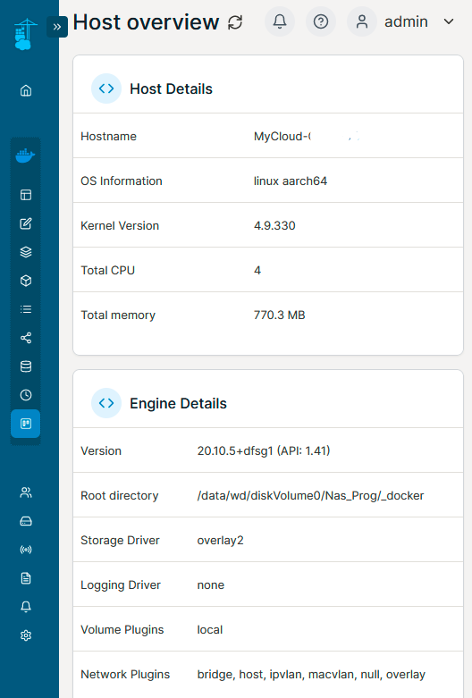

Following up on the modification of the original softwere…
Since we have been gifted with the 9.4.0 firmware update my modified system_init had to be done over again. On the upside I noticed that WD didn’t remove my Docker container I previously installed (some rsyncd for syncing with my other MCHs).
Teking in those good news, I installed Portainer right away, so next time I don’t have to enable shell access anymore but can use the web Gui if further containers are needed.
