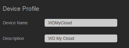

Open the Web UI and make sure that the device name is “WDMyCloud” in Settings>General

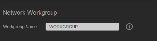

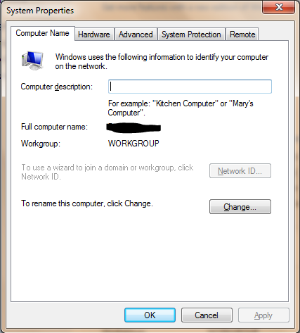

And under Network make sure that the Workgroup matches that of the workgroup of your PC.

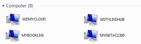

I have the default settings, haven’t changed anything.
The following is what I see under Network, in windows explorer. So I can right click on this and open the device webpage. But if I double-click on the following icon nothing happens.

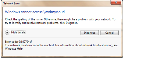

Also from Start > Run if I key in \WDMyCloud I get the network error message that I had posted earlier.

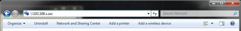

Also, you can try this.  Open an Explorer Window (not IE) then in the address bar type in the IP address of the My Cloud.
ie: \192.168.x.xxx

I get the network error if I key in the ip address in windows explorer.

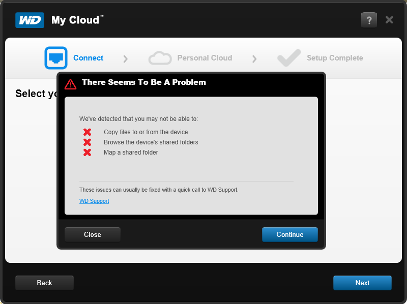

I re-tried the setup - mc_windows_setup.exe, so I am getting the following message.
