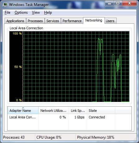

I think we are looking at some sorta SMB2 bug. I’m running a clean install of Windows 7 SP1
I went as far as wiping the drive clean AGAIN and using the debrick script to install a FRESH copy of 02.32.05-044 and still got the same slow speeds
One thing that sticks out to me in the graphs is the fairly flat heads on the graphs on the MBL running 02.32.05-044
It’s almost like the speed is capped when you compare it to the 02.11.09-053 graphs which are spikey.
At any rate I went from 44MB/s to 34MB/s transfer rates copying files TO the MBL after this latest firmware
And speeds FROM the MBL to my computer are effected as well
ISSUE RESOLVED!
SSH into the MBL and first backup smb-global.conf located at /etc/samba/smb-global.conf to your computers HDD and then edit /etc/samba/smb-global.conf
REMOVE “max protocol = SMB2” from the bottom of the file and save, then reboot the MBL and enjoy full speed again. Note that this may have adverse effects if running Windows 8
I Feel this more than proves there is a bug somewhere with the MBL SMB2 implementation
See graphs below for proof…
Original test after INITIAL upgrade to 02.32.05-044
First graph is 1gb file from computer to 3TB MBL on 02.11.09-053
Second graph is same file from computer to 1TB MBL on 02.32.05-044
