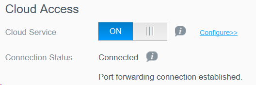

There is an ongoing problem with the MyCloud OS firmware and it involves UPnP.
I’ve just had to reboot the router. MyCloud services and Transmission are set-up and I’ve had to reboot the router. Transmission re-established it’s UPnP port mapping on its own after the router was restarted, but the My Cloud OS in the DL NAS has not.
Router says:
DL says (after about 10 minutes of the router being restarted.)
… and…
… showing that the HTTP port map is OK, but it’s not. The router is NOT forwarding the port and the Firmware in the DL NAS is not noticing that the router is forgotten the UPnP port mapping. If Transmission can notice this (it’s operating on the DL NAS) and the MyCloud OS3 can not then what’s wrong, what’s the bug? Now can this be fixed where MyCloud OS3 can monitor the router and if it’s noticed that the UPnP port mapping on the router is lost, for the MyCloud OS3 firmware to continue to re-establish the needed port mapping?
Clearly the status of OK is not correct. The work-around is to re-visit each network port mapping on the DL NAS and click on save where it seems the DL NAS then sends the necessary UPnP data to the router to re-establish the correct port mapping.
