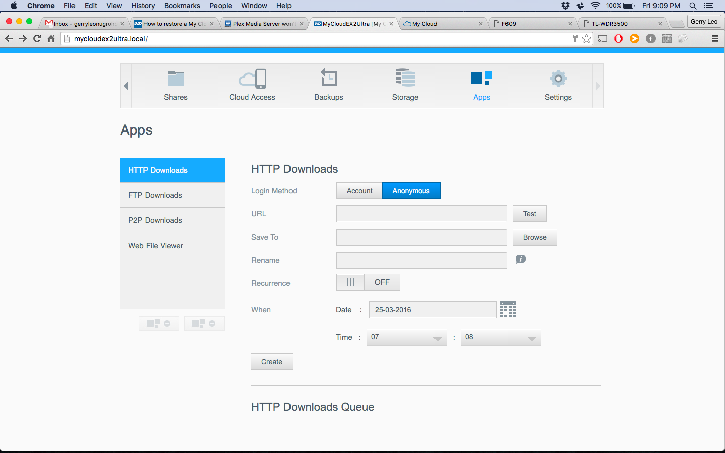

I figured, that’d solve the problem, it turned out the problem still persist, the plus button not showing-up still? This is weird.
So even after a fresh install, it didn’t solve my problem, though at first everything went well, the first time I brought this device home.

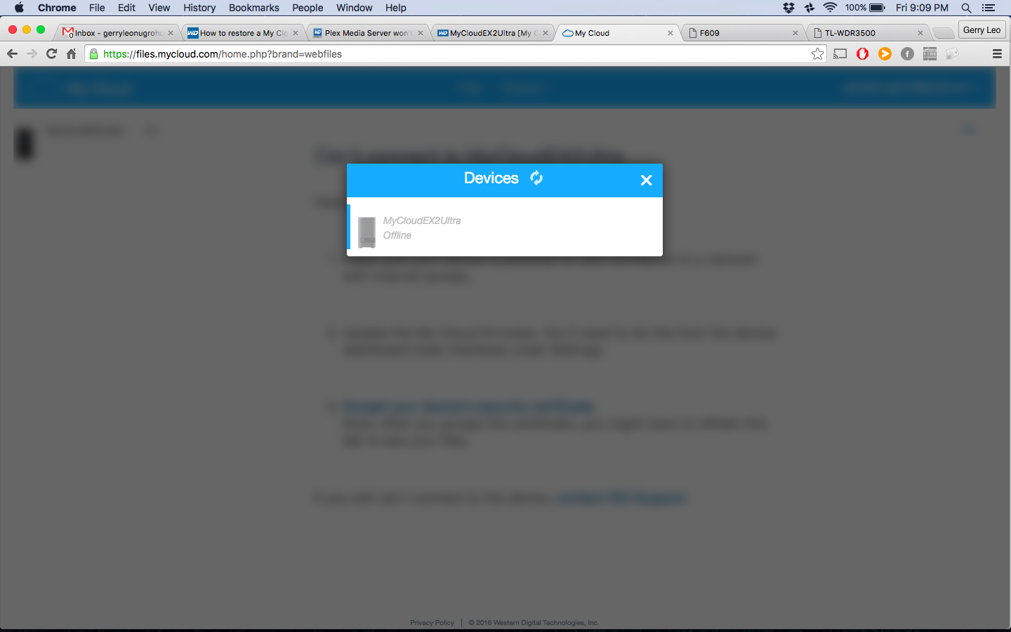

And now mycloud.com also saying that my device is also offline?
So anyone with other ideas?

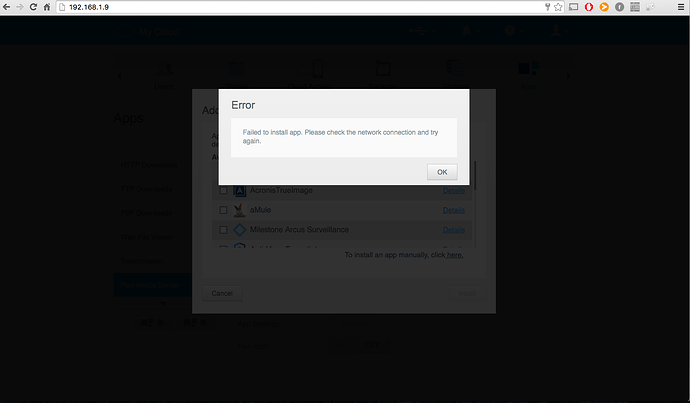

Okay @mike27oct, here’s what I did
- Login to the web interface
- Going to the app tab
- Turned off the Plex Media Server
- Did manual update, from the binary file found from Plex’s site
- And it returned me with the following error.
Any ideas what went wrong? For sure, there’s nothing wrong with my current connection.
Thanks,
G

Hi Mike,
Still getting the same error again and again. Not really sure what went wrong though. The latest release is far more stable than the pre-installed one, it’s causing the disk making noises all over. I wonder what causing the problem and preventing it from updating the systems while others have made it perfectly okay.
G
No idea, let’s hope others can help.
