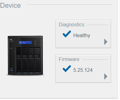

Saw this post and have had the same issue. But here is the fix YMMV this worked for me.
Current firmware in the drive is : 5.11.112 and would get the dreaded stuck at 99% Manual upgrade gave the message firmware file not found.
Rebooted the device and upgraded to this;
Then proceeded to upgrade manually to 5.25.124
