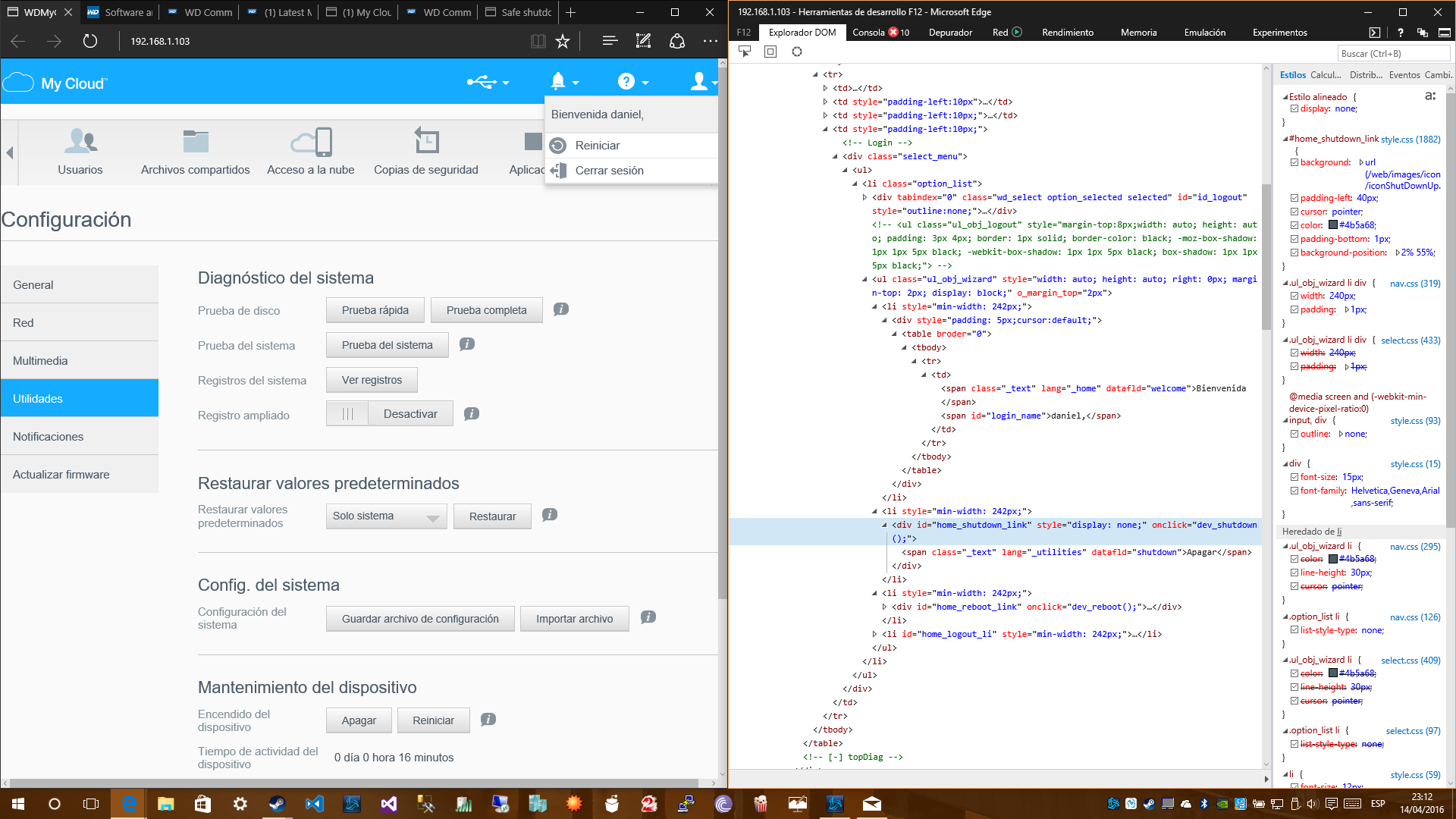

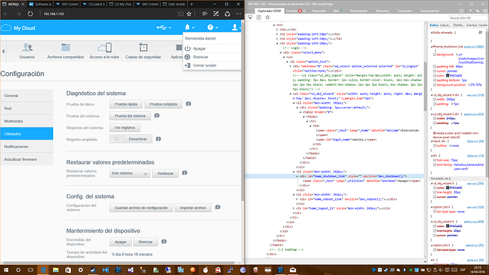

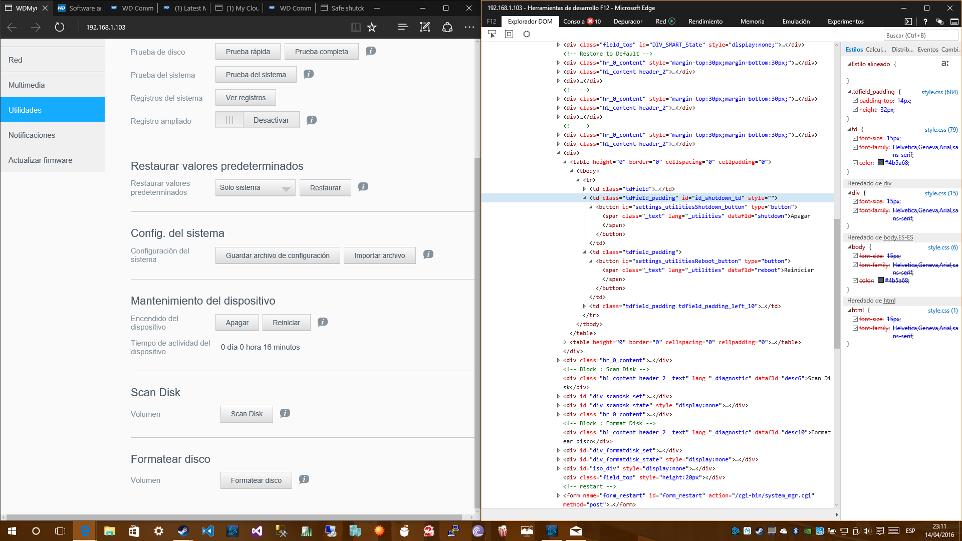

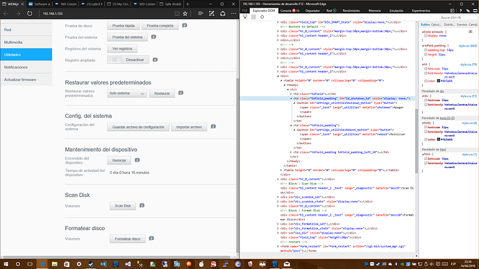

I have also found this error and noticed where the problem is: the CSS is hiding the button.
The following screenshots prove it.
Meanwhile Iâm sshâing and âshutdown.sh -h nowâ.
Hope this helps both the users and the devs!

Well Iâll be. . . . . dipped!
It looks like they deliberately quashed that functionality - or - they hid it during testing for some God Forsaken reason, and forgot to re-enable it.
Hot Dawg! Iâm going to have to go play with that and report results.
Huge, HUGE kudos for the excellent find!
Jim âJRâ
Nice find. Now only time will tell if WD thinks this is a serious issue that should be fixed. The missing shutdown button in v2.x has been known for a couple of months now and was not fixed in the recent firmware release for the v2.x My Clouds.
Of course if one is enterprising they could edit the firmware files/code themselves to correct the Dashboard shutdown error.
