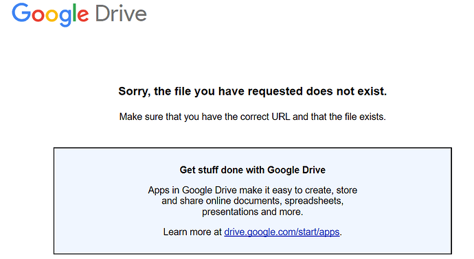

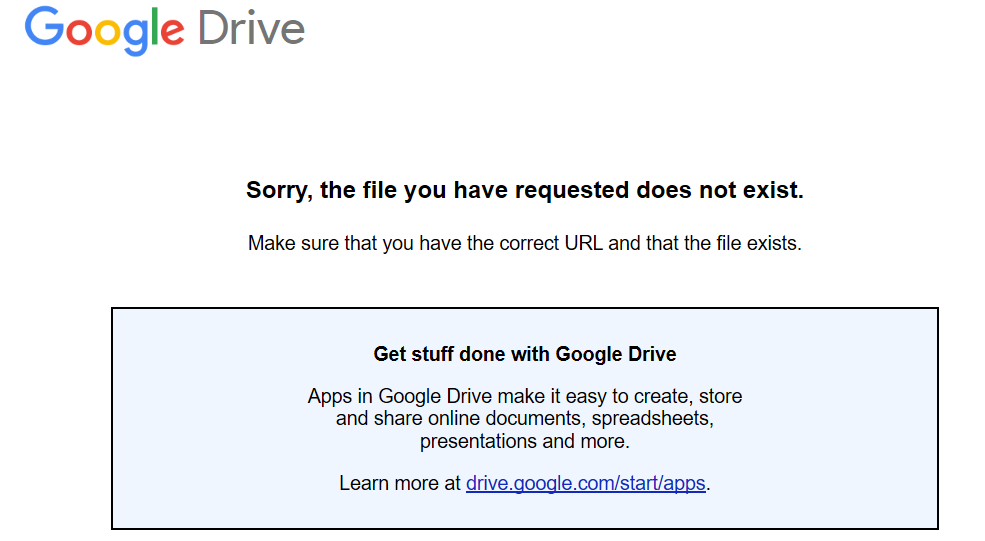

Hi the recovery file is no longer available. could you upload again? Thanks
Original instructions and files is here: https://fox-exe.ru/WDMyCloud/WDMyCloud-Gen2/

Hello, the link to download the file usbrecovery.tar.gz doesnt work anymore. Is is possible to provide another link? My MyCloud device did not react well to a loss of power and is now displaying a yellow light and not working anymore… Thank you for your help.

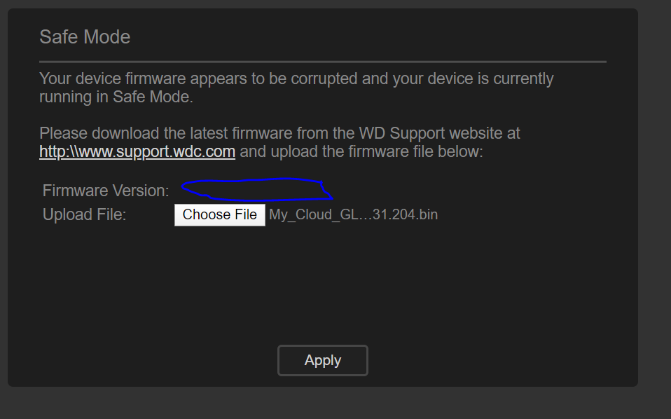

Hey @Fox_exe, really awesome stuff you’re doing and all. I was just wondering if you have any insights on the following. I followed all the steps to the letter, and now I am stuck on the safe mode page with no version number, and selecting the right firmware does nothing as well. I tried using the alternate method via telnet and all, and it does not seem to work or boot for me too, still stuck on the same. Thanks!

I’m trying to download the files. However I can’t access the recovery file. Is anyone able to share this please?

For me is it the same. Could you already find a soluton? Could it be, that the uImage uRamdisk datas for the safe/recovery modus from @Fox_exe are not correct working for every My Cloud Gen2 Devices? Is there any possibility to upload and install the firmeware bin data via USB Stick?
I managed to get it back up and working with quite a bit of elbow grease, and the help of my raspberry pi with a 3.5" HDD adapter. It’ll involve you taking apart the WD MyCloud, and in my case, I had to reformat it too.
You can check out the thread I followed here, WD MyCloud Stuck in safe Mode - #20 by ronaldyeojz. I had to google translate some of the parts but do look out for the commands portion as google translate will mess those up.
I hope this helps! Good luck!
I’m stuck exactly the same way as you. Can you elaborate on your fix? Is it a software fix or did it involve some hardware messing around? Many thanks!
It definitely requires some hardware messing around. I reckon when you are at the stage where the firmware number does not show up, you will probably need to reformat the whole disk? I tried with other files using the same steps but it just does not restore the firmware number for me, and in the end I went with taking apart the set, and restoring it through my raspberry pi system.

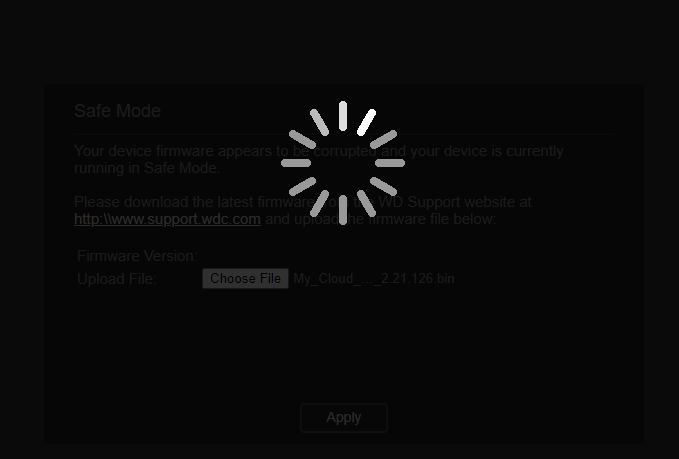

I’m able to access safe mode, but it stuck on spinner without percentage. Just spinning… No firmware version seen in safe mode window. What can I do?

Hi everyone, I have a WD My Cloud device, 6Tb, gen 2, and I haven’t found any info about unbrick this unit in particular. I followed the procedure described at the topic “Success recover my MyCloud 3TB with fast blue blinking light after update firmware!”, but like lot’s of people, I’ve got stuck at safe mode with “Firmware Version: (BLANK)”. When I tryed to Update the firmware at this point, the progress bar started to move, but no percentage was showing. There was no progress at all. Befor…
