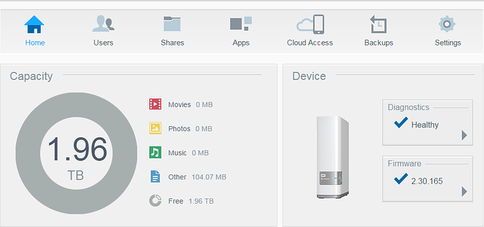

One of the things that stops the MyCloud sleeping is external network accesses. So WDSleepFix might disable Cloud Access (I don’t know, since I don’t have a Gen2 MyCloud, and haven’t used any of the ‘cracks’, or app installs). Disabling Cloud Access stops the internal indexing and thumbnailing process. These processes are required for the Dashboard ‘pie chart’ display, to allow the different data types to be identified. Due to the known security vulnerabilities, I currently have Cloud Access disabled, and this causes the pie chart to indicate capacity only in blue: data type ‘Other’.

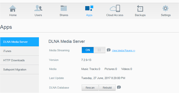

Twonky: have you enabled the Media Sharing on the shares containing media? Have you turned on the Twonky Media Server? Have you accessed the Twonky UI (port 9000) to see what directories it is searching in for media?

Now, DLNA has enable - Twonky working with port 9000, and sharing some folder.

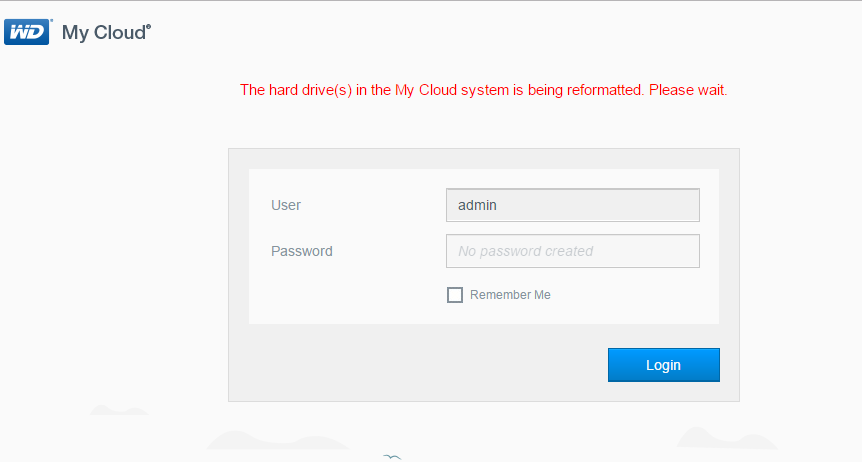

Now, i’m doing Quick Factory Restore in FW 2.10.310 by Google Chrome.
It’s loop:
  • It’s been 100% processing and then Rebooting (again and again).
  • Check by ping: MyCloud is not reboot, it’s always reply to my PC.
Is it process for Quick Factory Restore?
Philip.
:confounded: :imp:
I’m … unplug power core. Now MyCloud is: …
I think this step must be waited. Let’s Wait and See… !
Philip.
Dear All,
After re-format hard drive, update FW.
=> MyCloud working again! :innocent:
