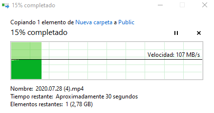

A) If I try to write a file in public space, using the Windows file browser, the speed is higher than 100MB/s.

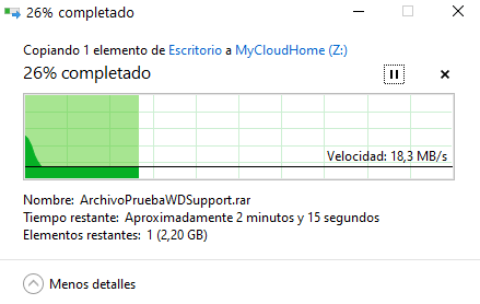

B) If I try to write a file in my user’s space, using the drive mapped by the WD Discovery software, the speed does not exceed 18MB/s.

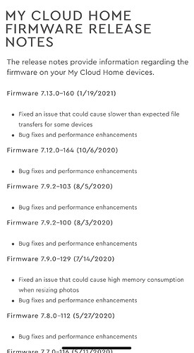

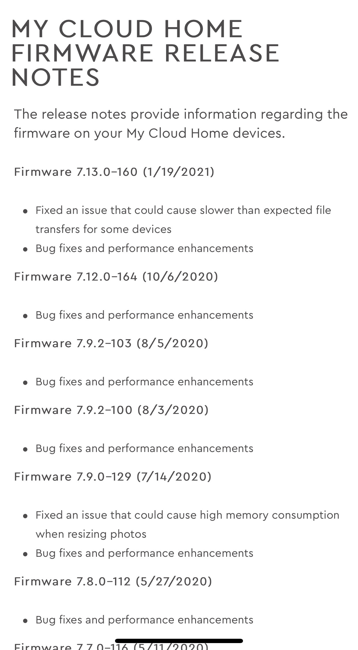

Maybe the new firmware release solve this problem.

Using WDDiscovery with my user logged in, and pasting the file into the virtual drive that is generated by WDDiscovery: 18MB/s.

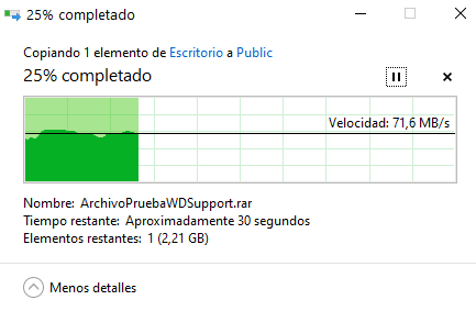

If I access the hard disk without the WDDiscovery software, using the Widnows network explorer and pasting the file in the “Public” folder: 71MB/s.

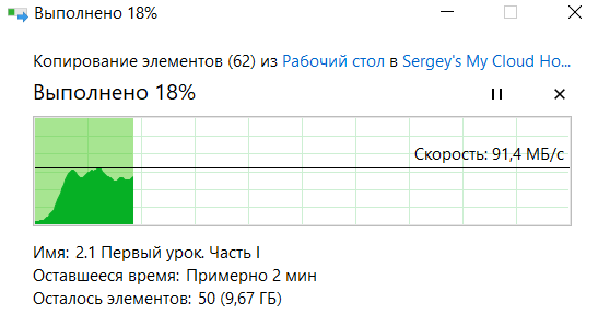

Hi! I could fix this problem after activation uPnP on my router and restarting MyCloud Home. Now I have ~100 MB/s transfer speed on Z: drive.

yes, in user area with WDD, not in SMB Public

That’s exactly my write speed, about 18MB/s.

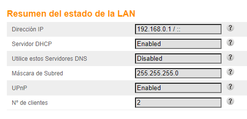

I went into the router configuration and saw that uPnP is already enabled… I don’t know much about network configurations, but it seems to be enabled, as you can see:
I have restarted my router once, restarted WD My Cloud Home several times and tested again and got a speed of about 110MB/s in public space, and about 18MB/s in the user space with WDDiscovery… The problem continues :frowning_face:
In my networks I have always had the router address as 192.168.1.1, I have recently changed company and this is the first time I have 192.168.0.1. I think this should not be a problem.

Mine is running 7.12.1-170 also. I don’t have the newer 7.13.0-160.
