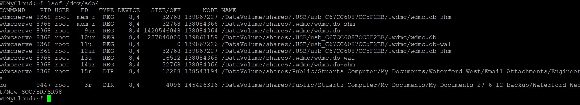

Still trying to unmount the sda4. I have attached a screenshot. Do you have any other ideas as extundelete will reportedly only work when the /dev/sda4 is unmounted. Thanks for you persistence.
Hey Ged. Please type: “lsof /dev/sda4” and show the output.
Sorry for the delay. I turn the device off when I am not using it so it won’t be running processes. When I restart, it takes forever to initialise. Now I am in via ssh.
Okay, type:
/etc/init.d/wdmcserverd stop
and then try to unmount (umount) it.
This will only stop the service, not disable, so in case of problems this service will be restarted after My Cloud restart. I personally have this service stopped by my startup script, because I don’t use remote access to MyClould, so I’m sure it’s safe to stop this service.
Thanks. Worked. Now I will go back to your original post and run extundelete (i have it on the attached external drive to the wd cloud.
Great! Good luck with extundelete. If you remember the folder name, try to recover only this folder (I think I posted a command for this in my big post). Should be quicker and hopefully folder structure can be recovered.
