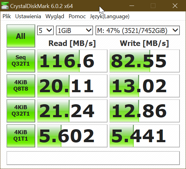

i use “Odroid XU4” as the second NAS (but there are currently newer models which work even better). It costs more than Pi, but it’s great. It has 2x USB3.0 and 1Gbs Ethernet. After minor tweaks to EXT4 mount settings (copied from MyCloud) I’m getting even better speeds from my external USB3.0 Wd My Book. NTFS speed (another My Book device formatted to this format) with “bigwrites” mount settings works much better than MyCloud, basically allows full speed. What’s beautiful is that external drives never wake up, because the whole system is on a micro-SD card. Not to mention that this device has 8 CPU cores and 2GB RAM, so simultaneous transfers are not a problem like on MyCloud. Also, when needed AES encryption/decryption works pretty fast, so could create protected volumes (however newer Odroid models than XU4 are better for it).
EDIT:
Test Results
MyCloud (internal drive):
(don’t know why read speeds for 4KiB Q8T8 and lower are so low. I repeated the test with same results)
XU4 with external Wd My Book formatted to EXT4:
XU4 with external Wd My Book formatted to NTFS:
