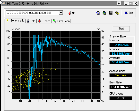

my 2TB WD drive is having weird slowdowns when writing also.  look at the first part of the graph, it was sitting at .2 for the longest time

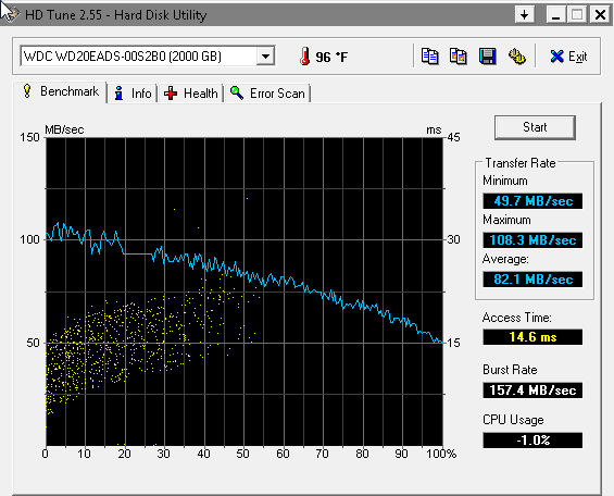

did another test and back to normal
