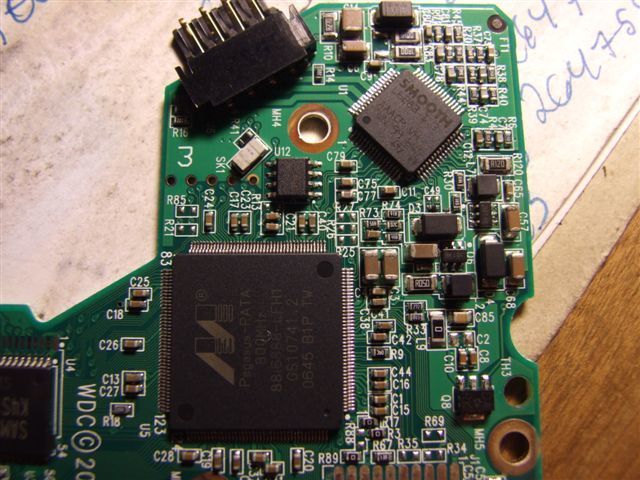

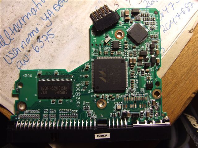

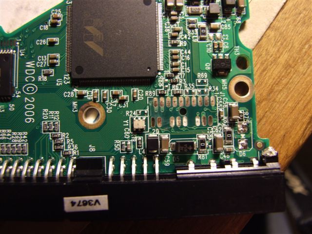

here are the photos of my PCB:
Any help would be appreciated on what I could try to revive my PCB!

Actually I was a little too hasty and removed D6 (de soldered) only to find out it was OK, it is not shorted. So i reinstalled it. D5 is not shorted either and the 0 ohm resitors that accompany D6 and D5 are good too because they give continuity. (I have a very simple meter which beeps when there is continuity and doesn’t when there is not…I am not able to set it to 200ohm scale, but if you think that is important I could borrow a meter).
I checked also D3 and D4 and they look fine (no continuity), as well as all the other 0 ohm resitors on the board - Ok too (all give continuity). I saw in another post the thing about cleaning the connectors with an eraser which I also did.

I can’t see any physical damage. The only thing I can do is to help you measure the onboard voltages, but that will most likely just be a post mortem exercise.
If the board turns out not to be economically repairable, then the easiest solution will be to transfer the 8-pin serial flash memory IC at U12 to a replacement PCB. The following PCB suppliers offer a firmware transfer service, either for free, or for US$10:

As for the measurements, you should do these with the board removed from the drive. You should also be very careful, as a slip of your probes can do major damage. Whatever you do, you must not damage U12.
You can start by measuring the voltages on each pin of transistor Q8 (near the bottom right screw hole). I believe these should be +3.9V, +5V, and +3.3V. The latter should be the Vio voltage for the flash memory, Marvell MCU, and SDRAM.
Next measure the voltages on either side of the R050 resistor between L2 and C3, to the right of the MCU, at about 1 o’clock. That should be the Vcore voltage for the MCU.
Lastly, measure the voltage on the anode pin (non-striped end) of Schottky diode D4 (adjacent to L2). This will be the -5V supply for the preamp inside the HDA.

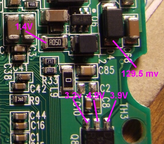

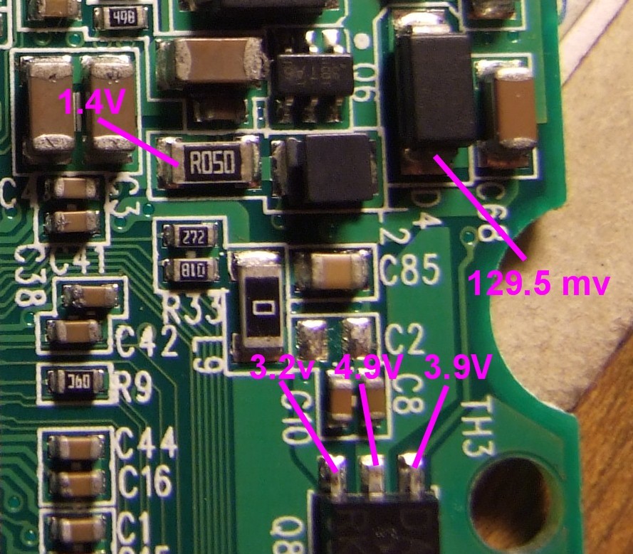

Here are my measurements. Looks like D4 (anode, non-striped end) is giving me 129.5 mv ?? I have a good meter now analog, which would go to minus (negative) it such was the case.
What next?
TKs

Thank you very much for the feedback.
You have confirmed that the Vcore and Vio voltages are OK. This in turn confirms that the SMOOTH motor controller has at least some sanity (it controls the regulators). I would also confirm the the zero-ohm resistor at L9 is OK. The voltage at its top end should be +3.2V. If not, then there will probably be a short circuit on that supply rail.
I wouldn’t be too concerned about the absence of the -5V supply. Some good boards will also behave in this way. I don’t know if this is because the MCU switches this supply off if it doesn’t detect a preamp, or perhaps the supply doesn’t like operating without a load.
My next step would be to install the PCB on the drive, power it up, and measure the voltages at the motor terminals. There are 4 test points marked E50-53 on the rear of the PCB. If the motor is trying to spin, then there should be some activity at these terminals.
I hesitate to say this, by you could also measure the motor current at the current sense resistor, R10 (marked as R270 on body). On the rear of the PCB, there is a corresponding unlabelled test point between E3 and E50. If you wish to use this test point, then you will need to be extremely careful that you don’t short it to the adjacent ground plane, otherwise major damage may result. You would need to use the 200mVDC or 2VDC ranges on your meter. The resistance of R10 is actually 0.27 ohms, so a motor current of 1 amp will produce a sense voltage of 270mV.
