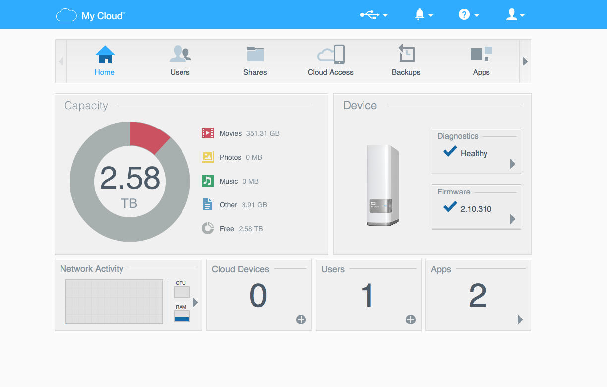

I own multiple My Cloud Mirror and My Cloud single drives and this is definitely a single drive with the latest My Cloud Mirror Firmware release installed. I presumed this was the correct sub forum to post in but am new to the community. Here is a screen shot that confirms the firmware on the single drive.
I checked my activity log and it seems that the firmware updated shortly after installation. You can see the addition of the horizontal scroll bar at the top of the image, I think the additional heading contained is ‘Apps’. As previously mentioned the interface under some of the tabs i.e settings is designed slightly differently.

My suspicion is that you’ve logged in to the Dashboard of one of your Mirrors, not your new 3TB MyCloud…

Ricard_0 that appears to be the Mirror interface. The single bay My Cloud units do not have a firmware version below 03.00.03-413 which was the initial firmware release for the single bay My Cloud units. The latest firmware for the single bay My Cloud units is v04.04.01-112. The latest firmware for the My Cloud Mirror is 2.10.310. The “Apps” tab/field is a dead giveaway as the single drive My Cloud units do not have a tab for Apps nor do they have a Network Activity graphic on the Dashboard Home.
You may want to check (on your router’s administration page) the IP addresses used by the devices on your network and ensure you log into the correct My Cloud device. When using multiple My Cloud devices on the same local network one will need to use a unique “Device Name” (Settings tab on Dashboard) for each My Cloud unit.

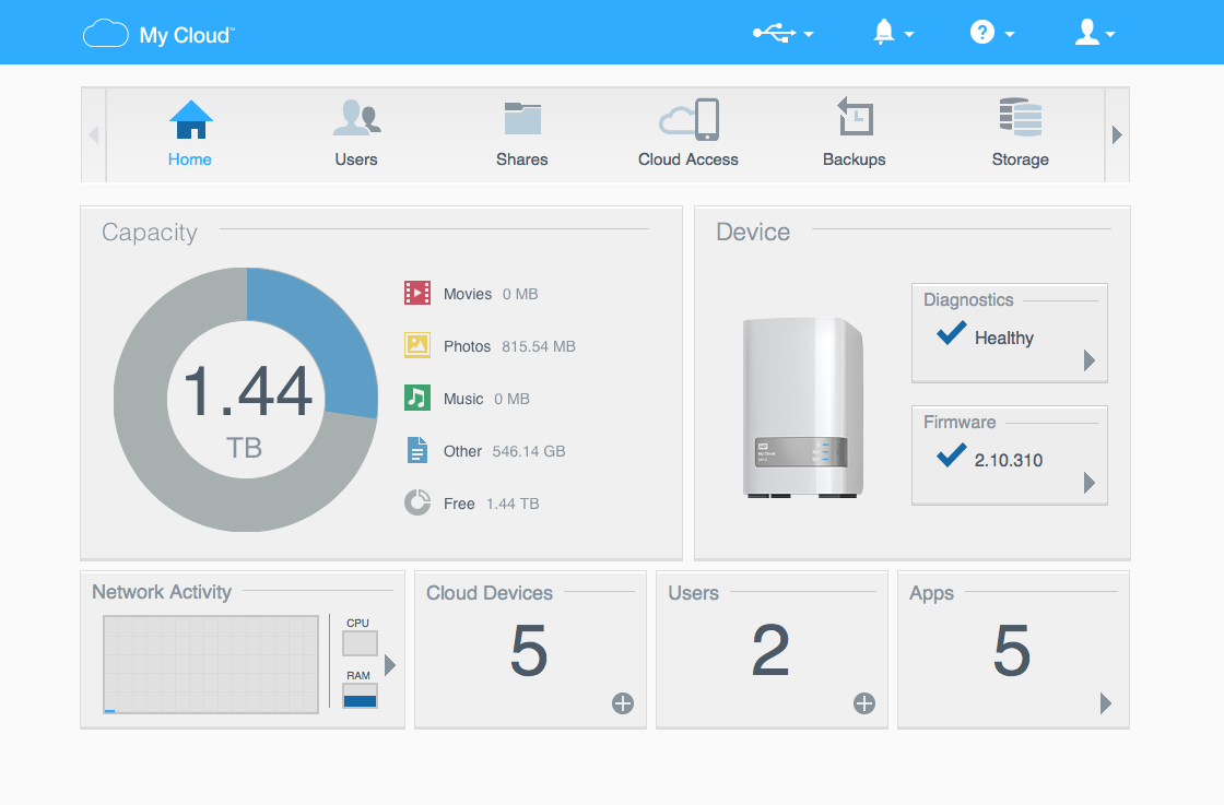

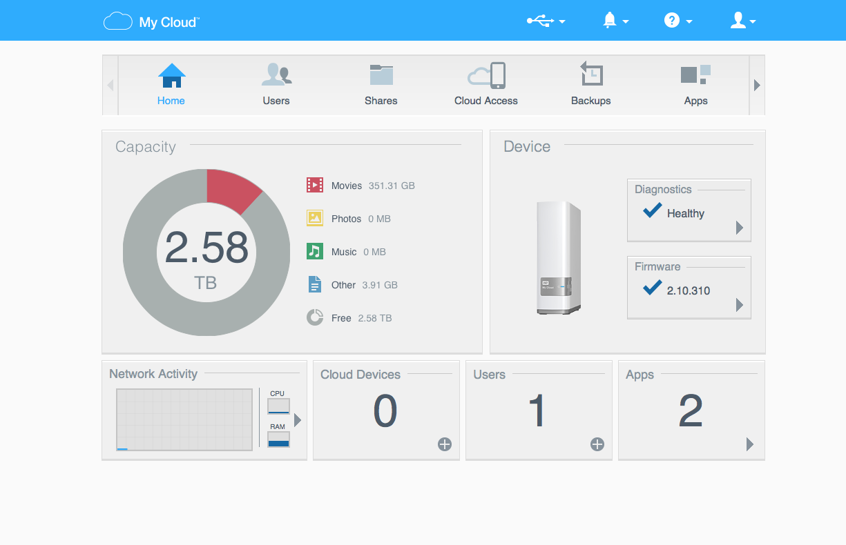

So, got home tonight and Ethernet Cable had arrived so connected the existing My Cloud Mirror.
This is what I now see on my MyCloud Single Bay 3TB Drive
…and this is what i see on my MyCloud Mirror 2x2TB Drive
I am now convinced that this new MyCloud Single Bay 3TB Drive has firmware 2.10.310 installed.
Please let me know if I am missing something obvious here ???

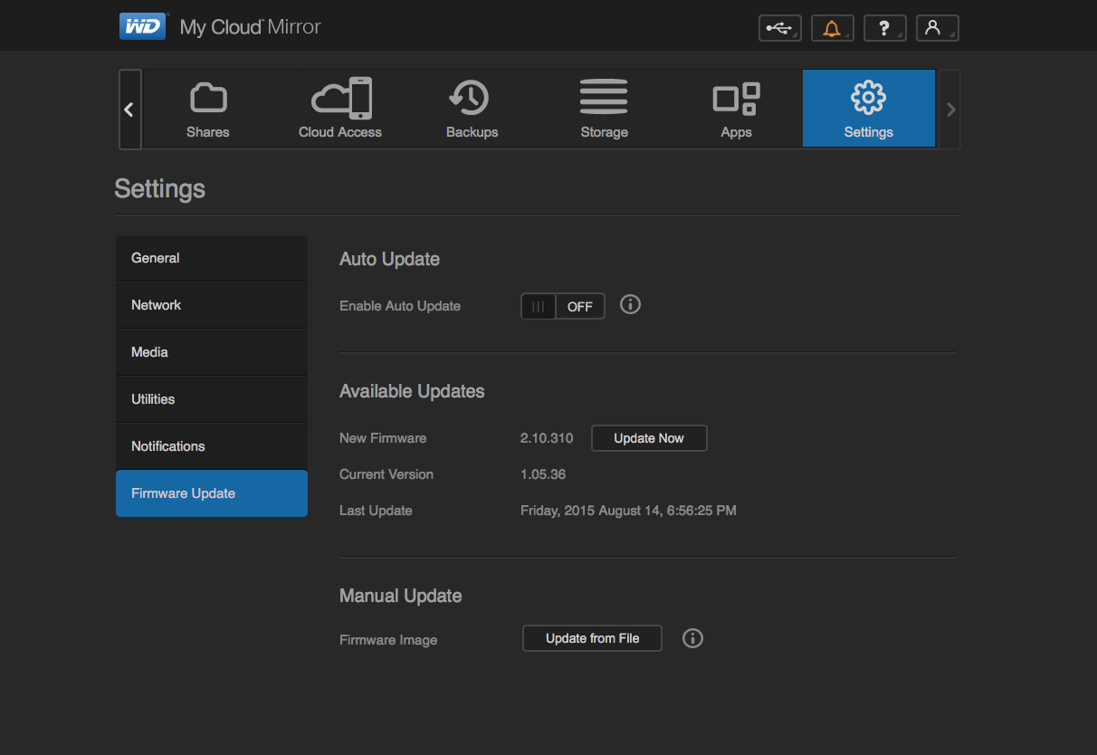

Following firmware update on MyCloud Mirror drive
Note, this image shows the “Storage” field/tab whereas the image on the MyCloud Single Bay Drive does not contain this.
Conclusion = I have a single bay drive running Firmware 2.10.310 :)smile:

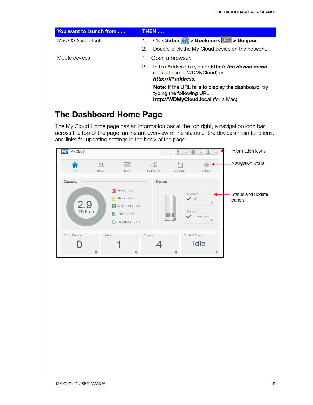

I’ve just remembered the Japanese model, the ‘WD Cloud’ (MyCloud name is owned by someone else in Japan, I think).
This has a dashboard that looks like that (except it says ‘WD Cloud’, rather than ‘WD My Cloud’); in fact, when OS3 was announced, someone found the manual, and we all thought it was for OS3. See p18:

Looks exactly like the dashboard shown on page 18 in the manual.

Intersting. The product numbers being different. Wonder if some units that weren’t supposed to be released yet slipped out. Which manual were you looking at where the Dashboard looked like the one on “page 18”? There is no image of the Dashboard on page 18 in the English version of the My Cloud User Manual: http://www.wdc.com/wdproducts/library/UM/ENG/4779-705103.pdf
The first image that I can see of the Dashboard in the English User Manual is under Chapter 5, The Dashboard Home Page (page 31). And it is the current My Cloud Dashboard.
