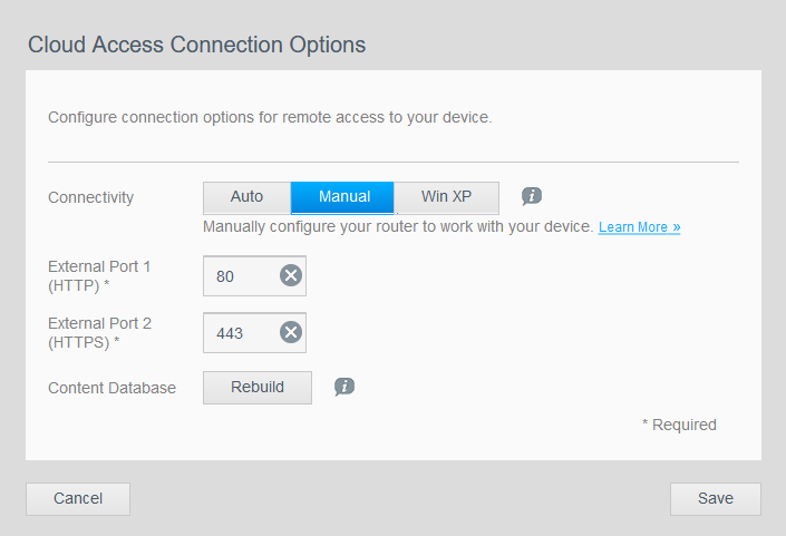

Make sure Remote Access is enabled, then select the Configure link. The following dialog window should appear.
Under Connectivity, select Manual. The dialog window will change to reflect the Manual settings.
The default external port values are 80 and 443. Often one’s broadband provider will block port 80 and 443. Either use the existing values or change the values to ports that are not blocked by your broadband provider and or that are not used for external access by any other devices on the local network. What ever you choose make note of the two values as you will need them when you enable port forwarding within your router. In the example below the values were changed to 8080 and 4443.
Select the Save button to continue. You will be returned to the Cloud Access section where the My Cloud will attempt to make a connection. The port forwarding process IS NOT finished yet!!!

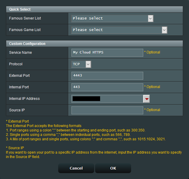

The important thing to understand is the two values you noted from the My Cloud Cloud Access Options dialog window are the EXTERNAL port values that you will use in the external value entry field when setting up the port forwarding rules entry on the router. Understand that you will usually have an external port value and a internal or local port value when setting up port forwarding rule in the router. Typically for the internal/local port will be 80 for HTTP and 443 for HTTPS. So if one uses the default values they would be: external port: 80 - internal port: 80, external port 443 - internal port: 443. Or if using the values in my example above the values would be: external port: 8080 - internal port: 80, external port 4443 - internal port: 443.
What follows are some port forwarding setup screen shots from an Asus router that reflect using external ports of 8080 and 4443.
Note: If one has a Protocol option one may want to select Both although using only TCP works for me. YMMV

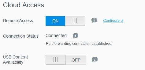

Once one has properly setup port forwarding within their router one can return back the My Cloud Dashboard. Then navigate to Settings > General > Cloud Access and check to ensure the Connection Status indicates: Connected Port forwarding connection established.
At this point remote access, using port forwarding, should be working properly.
If the Connection Status indicates failed, check the port settings both in the My Cloud and in the router again to ensure you are using the same values for the external port and that the internal/local corresponding port matches 80/443. Also ensure you have selected the My Cloud as the internal/local device the port forwarding rules should point to.
