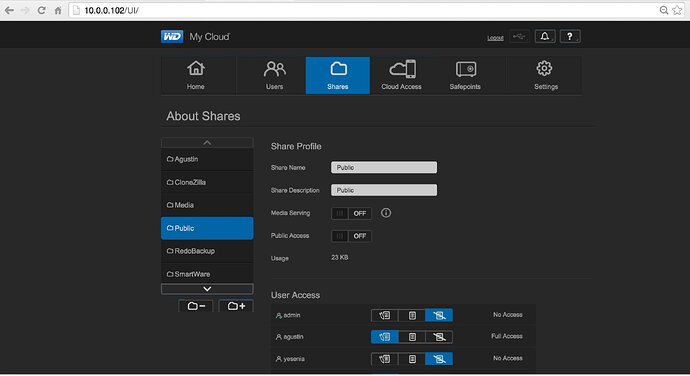

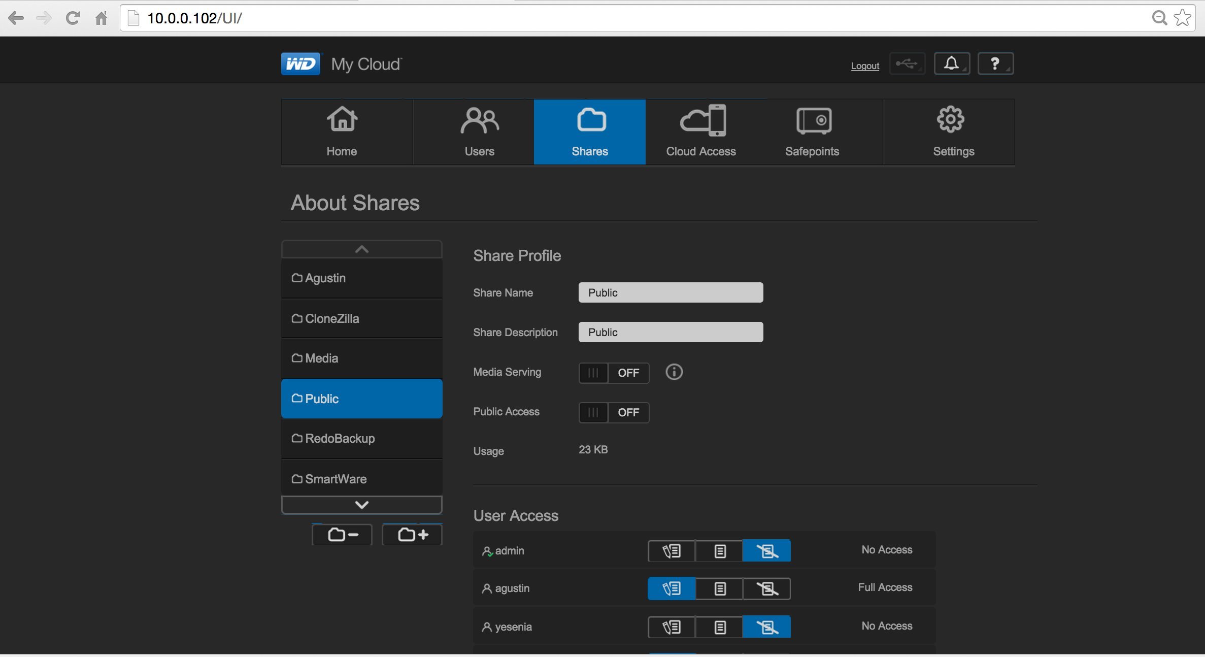

Not sure if this works for you but I found a bug back when the device first launched (You’re the first person I’ve told). I was bored and clicking randomly, spur of the moment type thing. I actually really hope it doesn’t get patched by telling you since its been GOLD for me, but here goes.
Log in to its WEBUI by typing its address into a web browser
Click on shares
Click public
Now very quickly switch between any other share and immediately back to Public Share page.
Example: Look at my pic below I’ll click very very fast between the Agustin Folder and Public Folder. it can be any folder though and the trick is to click super fast so that the page doesn’t finish loading before you sent it back the public folder setting page.
Repeat step 4 very fast until the “Public Access” slider switch unlocks. I own both windows and mac machines and have noticed it works betting on windows. Macs load the page faster and the bug occurs a lot less frequently but I does work on both platforms. I tested it on IE, Chrome, and Safari. Replicating it with my instructions should be easy but let me know if you can’t.
In Your case set the switch it back to the ON position and you should be set
Tell no one, I’m hoping WD doesn’t find out about this.
(pic below, it might have to be approved by a MOD first be patient)
