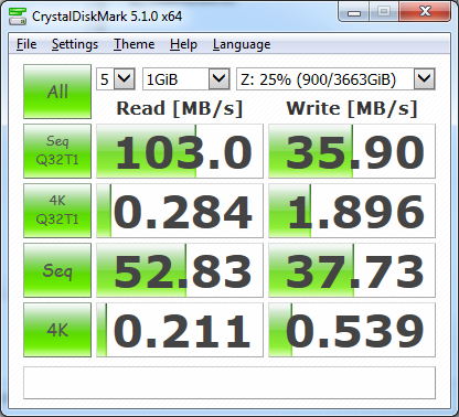

Has anyone benchmarked their MC unit? I’d like to see how yours stacks against mine. I used CrystalDiskMark to capture MC 4TB (RMA’d) and replacement MCM 8TB (4TB RAID 1) performance. They were tested one after the other.
@NIGEL_STONEMAN I think you maybe experiencing what I had in regards of performance.
My Cloud 4TB
My Cloud Mirror 8TB Gen 2
Windows 7 Ultimate
i7-2600
8GB
1G Network
