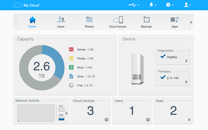

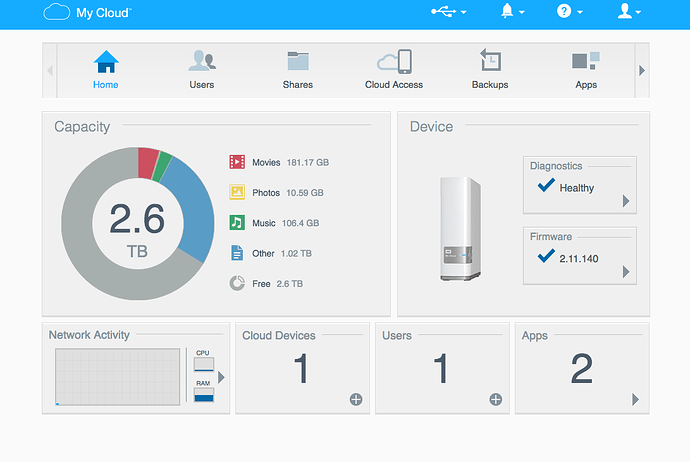

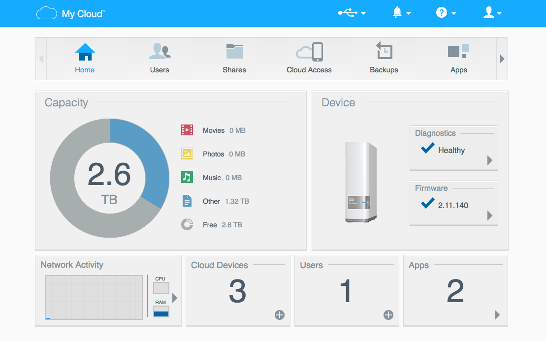

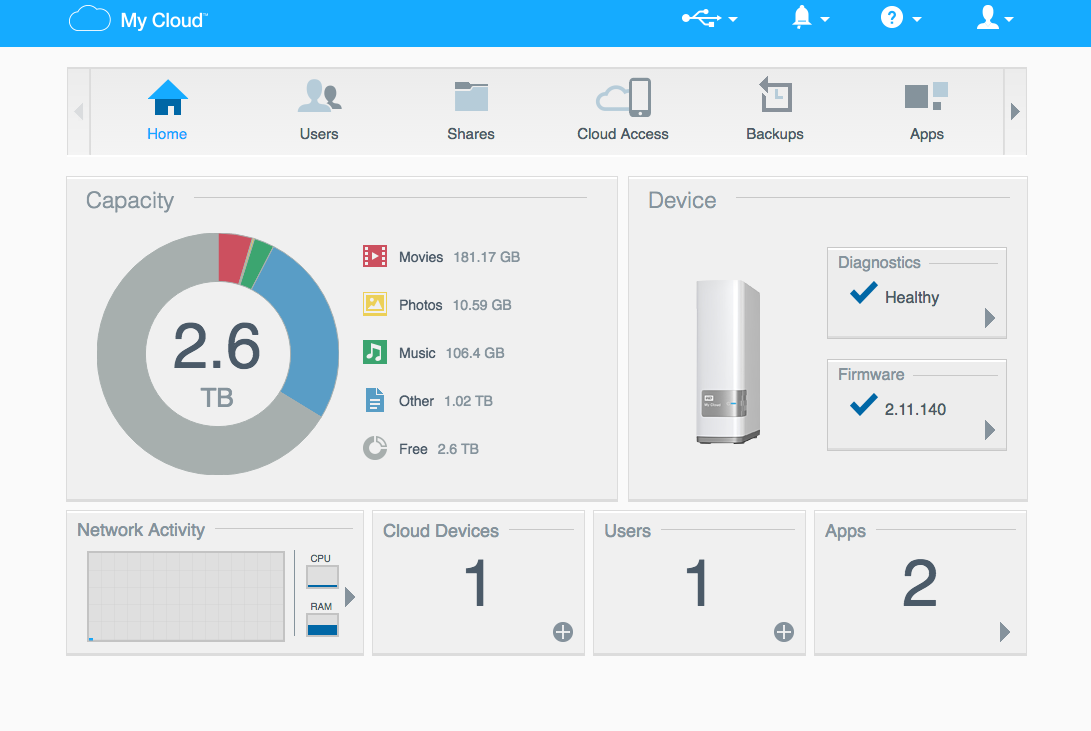

Have now set static ip up for it and it now let’s me in at wdmc.local, however before this it told me how the usage was split up, so much music, so much movie etc, now there are no music or movie etc, just 2.6Tb free space. have included two screen shots, B4 & after. No biggy I suppose if it gets the thing working.
