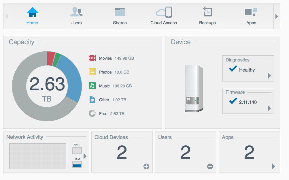

What model/version My Cloud are you using and what is the firmware version? The firmware version is typically listed on the main home Dashboard page under Firmware.

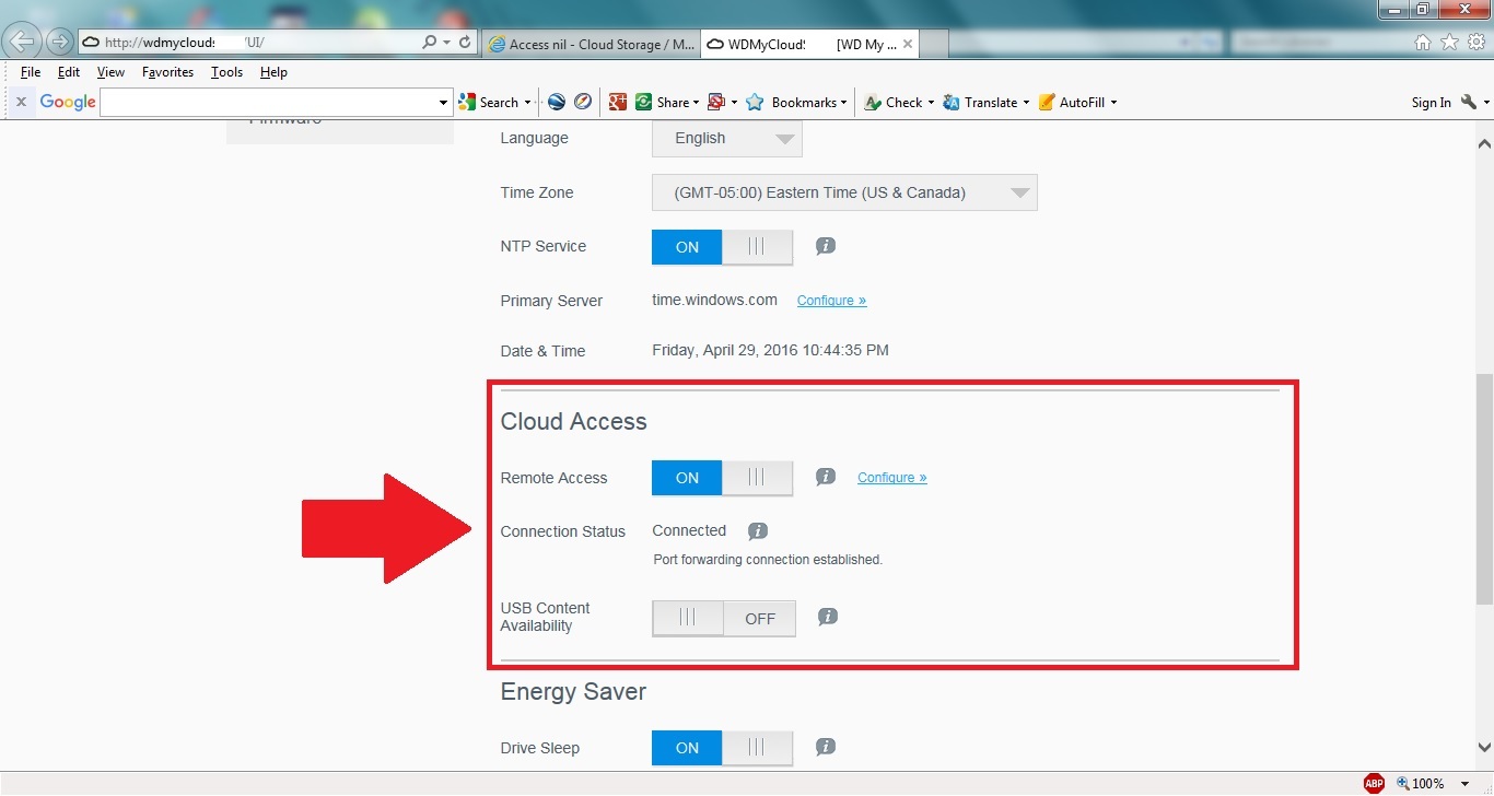

On a v04.04.02-105 firmware single bay My Cloud below in the red box is what appears for the Cloud Access section under the Dashboard > Settings > General page. Note the Connection Status line which shows how or if the My Cloud remote access is connected and working.

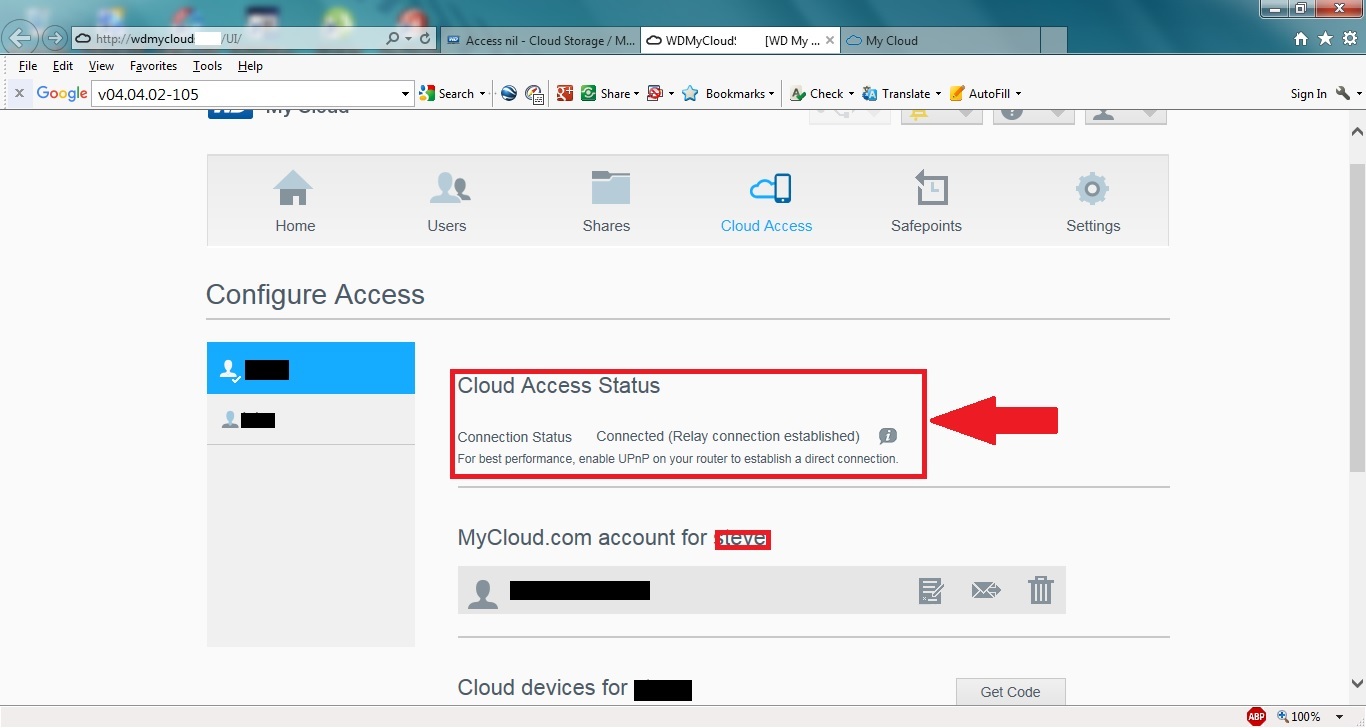

Below is how the Dashboard > Cloud Access page looks and where it indicates its connection status.
When one connects through the Mycloud.com web portal they DO NOT access the Dashboard, rather they see a listing of the Shares on their My Cloud that they can access remotely. When one connects to the My Cloud using Mac Finder or Windows File Manager they are generally accessing the Shares of the My Cloud NOT the Dashboard.
If the My Cloud remote access isn’t indicating connected for a status then remote access through the MyCloud.com web portal most likely will not be able to access the My Cloud.
It’s a my cloud, 4tb single disc, Firmware I updated last week when I got it, it is 2.11.140 and says it is up to date.
