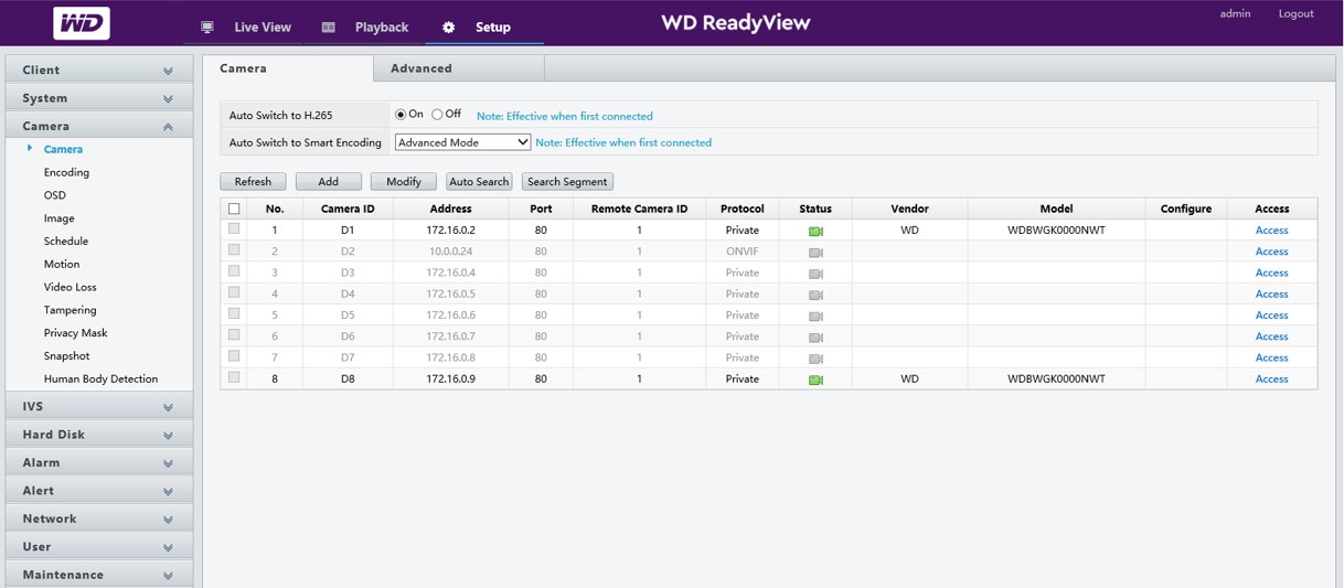

Since WD doesnt offer a dome camera solution, I purchased a Swann SWNHD-866MSD. It’s a basic ip poe dome camera. The NVR sees the camera but it will not go online.
Any help would be greatly appreciated.

It is the camera with the 192.168.1.10 Address? See if you have an option the change it to something like 172.16.0.XXX (xxx = 1 - 253), make sure not the use the same IP address the other camera. I know most of the NVR systems do not allow other vendor camera hookup to their system. Good Luck!!

I was doing some research and came across this thread. From the screenshot I saw above it looks like the IP address of the camera you wanted to add needed to be changed to match the network. It looks like the cameras have a 172.16.0.## IPs The camera you wanted to add has 192.168.0.10. Which was probably a default IP address. If you were to connect it to a laptop in the same range like 192.168.0.100 with the use of a Poe injector you could log into the camera via web browser/webpage (open web browser and type in 192.168.0.10 in the url bar it may ask for a user name and password you could probably google default user and password for that make model camera)and change the IP address to match your security system. Usually under network or something like that. This would basically work for any IP camera. Hope this helps.
After several attempts I have successfully added two (2) non WD dome cameras to the NVR. Support is limited in the WD advanced manual. The 1st camera is 4MP POE IP Camera IPC-HDW4433C-A Amazon $60. The 2nd is REOLINK PoE IP Camera Outdoor 5MP Amazon $50. Both cameras need to be initialized prior to connecting to the WD NVR. Both require their own configuration software to be downloaded and a 12v power supply. Configuration requires setting a static IP address, like 172.16.0.xx, and all of the initial parameters including, date format, and other specifics, most of which cannot be adjusted within the WD configuration format. After initializing the cameras then can be connected to the WD NVR, Camera needs to be configured and added into the camera summary. This is the confusing and undocumented configuration not specified in the WD documentation. Camera needs to be set to ONVIR and not plug & play. After adding the cameras they came online after about 10 minutes.
