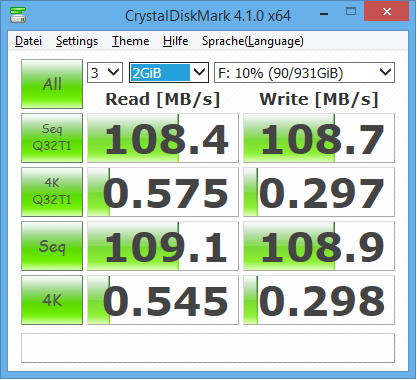

my testing system is Intel i7 with onboard USB 3.0 connectors (ASUS All-in-One ET2702IGTH) , speed of Passport Ultra Metal is above100 Megabyte/s. Attached the CrystalDiskMark screenshot:
Please note that the benchmark results can vary depending on the system you used for the test.

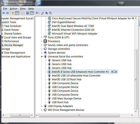

Example of my system:
I would try to update the Intel(R) 8 Series controller, Intel(R) USB 3.0 Root Hub and Intel(R) USB 3.0 eXtensible Host Controller, other USB 3.0 related devices are the Intel (R) USB 3.0 Root Hub and at the end the normal USB Root Hub.
All “USB Composite Device” and “USB Mass Storage Device” are attached devices not needed to be updated.
Your screen may vary if you have a different USB controller like a Renesas for expamle.
