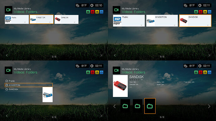

ok here it is … the only view that will not display them is “Gallery View”
This is due to the “Design” and techinical limitation of what’s possible.
It’s only possible to have “One” focused drive icon (as seen in the picture at the top of this thread)
Stearms theme does not have this (and there is really no place to put it)
http://www.mediafire.com/download/6966q93j69b5c9s/Drive_Icon_stearm_js.zip
that’s all i can do unfortunately. take it or leave it.
anyways back to other things
How to use it:
Step 1: get a image eg. google images … resize it to 200x300, name it Exactly the Same as how your hard drives appear as “text” eg. if the WDTV says WD MyPassport then save the image as WD MyPassport.png
Step 2: remove the file extension eg. WD MyPassport.png > WD MyPassport
Step 3: unzip the Theme and place the icon (WD MyPassport) into the root of the theme (you will notice i’ve placed to icons already USB1 USB2
Step 4: rezip the theme at root level using NO compression … then upload

Can’t explain it any simpler …
EXAMPLE: if the WDTV says KINGSTON then save the image as KINGSTON.png
Step 2: remove the file extension eg. KINGSTON.png > KINGSTON **
Step 3: unzip the Theme and place the icon (eg. KINGSTON ) into the root of the theme (you will notice i’ve placed to icons already USB1 USB2 (see pic below)
Step 4: rezip the theme at root level using NO compression … then upload it to you WDTV

http://i.imgur.com/T4TrhAr.png
you really are strong friend I succeeded
you are a GREAT :smileyvery-happy:
