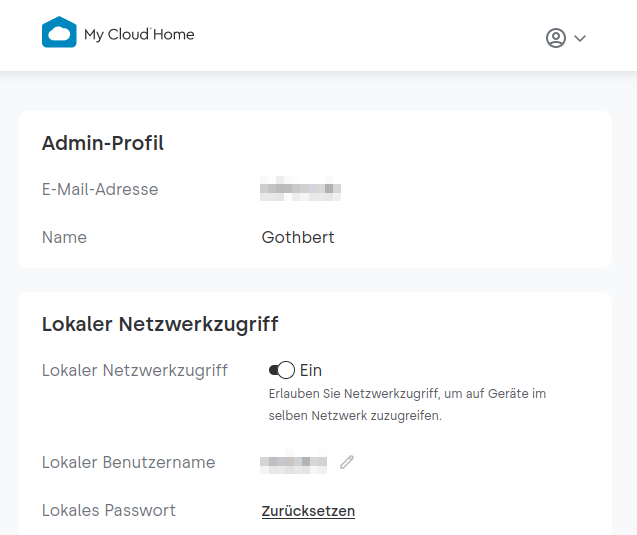

I have a totally reset MyCloud Home Duo freshly connected to my WD account via the app. The device is in the same subnet as my PC.
I can access the device via https://home.mycloud.com but I cannot manage it because the connection type is “Relay”. Clicking the “Manage device” links informs me that I should be connected to the local network (which I am). Downloading the Debug logs from http://LocalIP:33284/cgi-bin/logs.sh works, though.
I can also access the web interface of the device directly with its IP address in my local network. Though, after login, I see only the “Admin profile” and the “Local network access” boxes.

I think I am missing some very basic understanding of how administration of the WD MyCloud Home Duo actually works. I need to better understand the inner workings before trying this and that.
My expectation is: if I have the device right in front of me on my desk, connected to same network segment, the web frontend of the device can be reached and I can log in, then it should be possible to just configure the device locally in the frontend. No router, UPnP, WD services involved. But what I see is what I have shown in the screenshot.

I can access the web interface of the MCH by direct HTTP connection to the MCH’s IP address and log in, turn on local network connectivity, but cannot manage the settings to enable NFS on the MCH.
