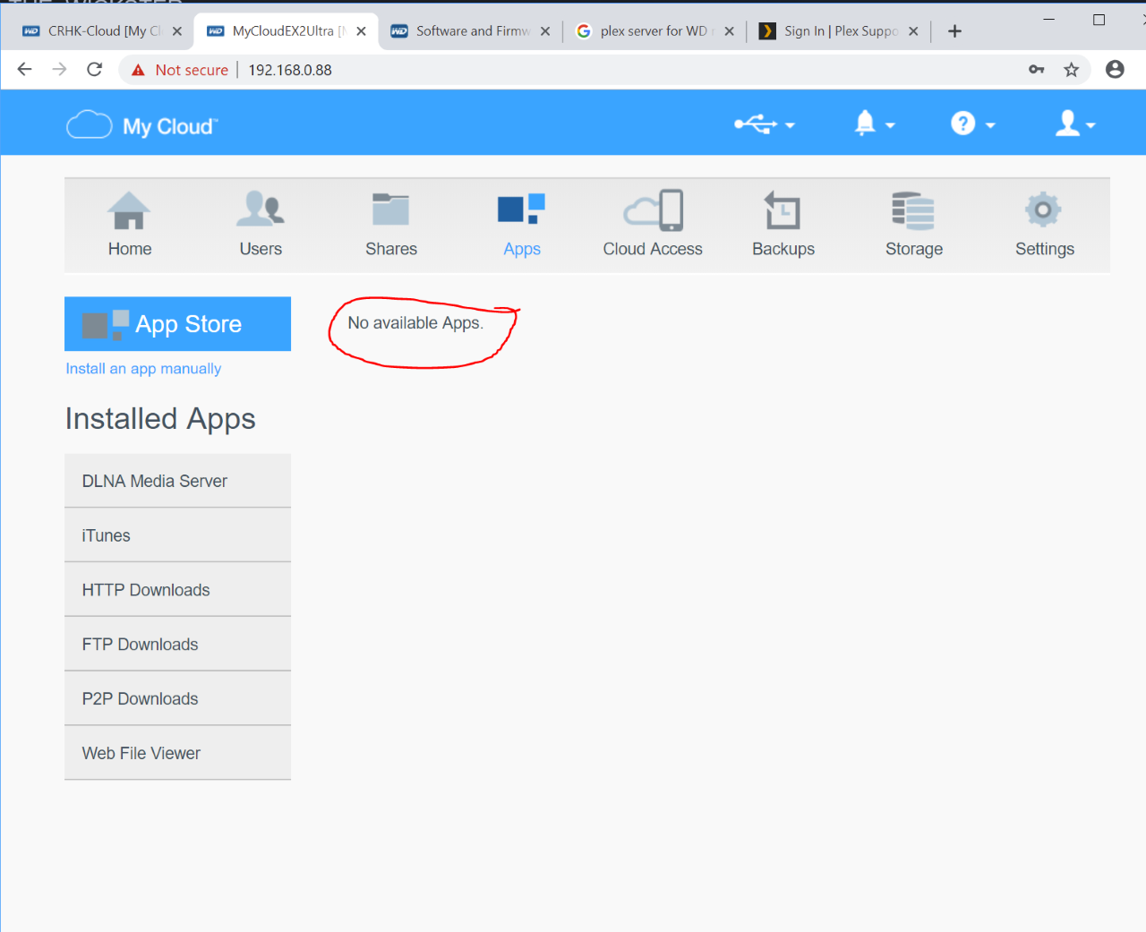

  10. Logged on and went to Apps on the dashboard
  11. Dashboard shows “No available Apps” (see screen shot 2 below)

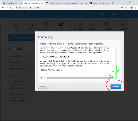

  12. Clicked “Install an app manually” and the Licensing Terms and Conditions dialog box opens
  13. Scrolled to the bottom right of the agreement, clicked Accept - NOTHING HAPPENS (see screen shot 3)

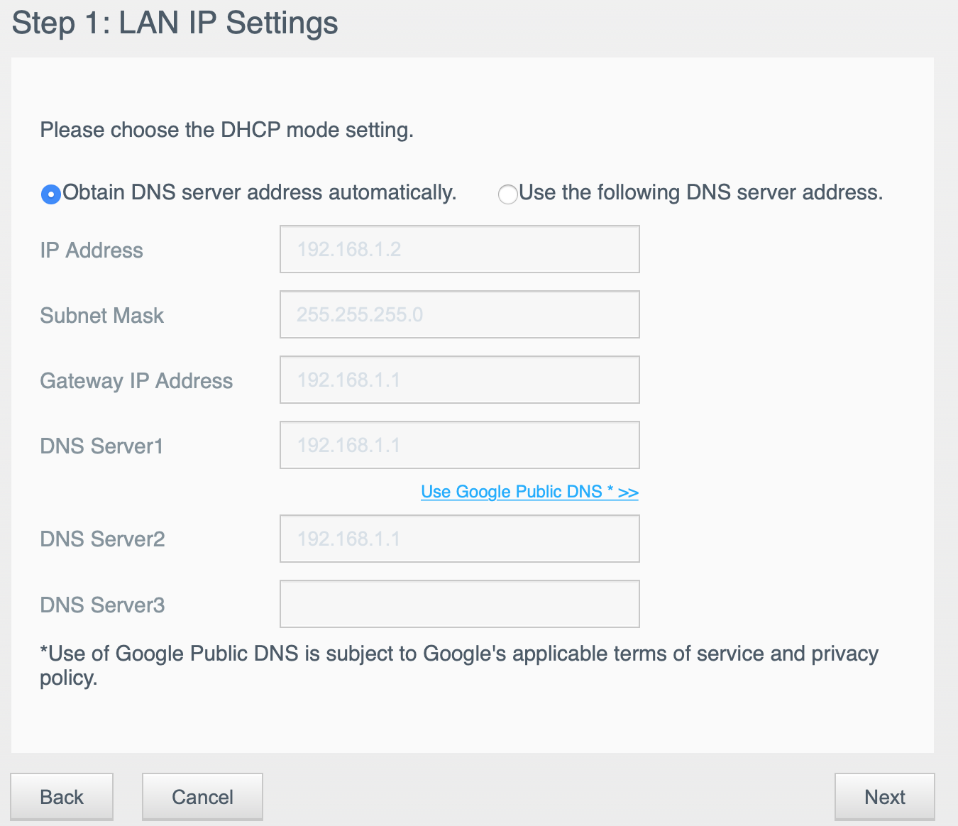

Had the same issue and resolved by changing EX2 DNS.
Working fix for me:
Just use manual IP address and google dns server…
works 100%
