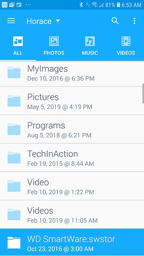

@wongjimcl Here is what I have done to work around this. I have another share created, Horace, and the same thing that is backed up to the SmartWare share is backed up on it. Another way is to move the SmartWare share to the Public folder, this may take a while depending on how much you have backed up. See example images below. Click on, tap or activate image to enlarge them.
