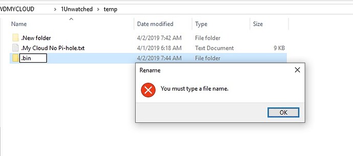

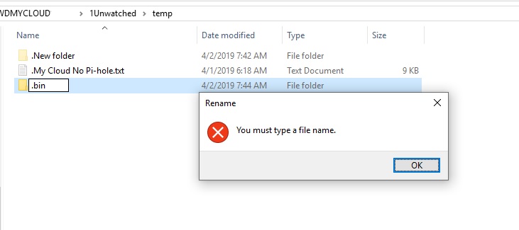

Cannot create a .bin folder on my first gen single bay My Cloud using Windows 10. But can create other folders/files using the period/dot.
