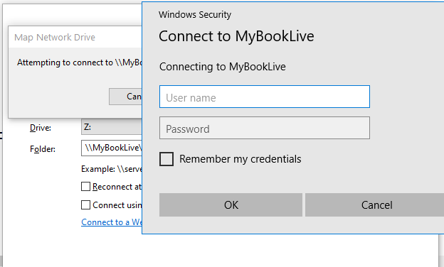

It’s exactly the same behaviour in File Explorer and WD QuickView.
I see a dialog box requesting User ID/Password.
The same dialog box is displayed one more time after I entered valid credentials and so on …

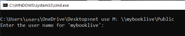

One more symptom is a prompt to enter a User Name when using “Net Use” command:
Previously this command was completing successfully without any prompt.
In the image of the Map Network Drive dialog in your second post, I see the bottom checkbox checked:
That checkbox says “Connect using different credentials”. I assume you’ve been trying everything, but just in case, have you tried with that box unchecked?
mb0w81651, it’s the same:
Anyway, I do not expect this dialog box at all.
