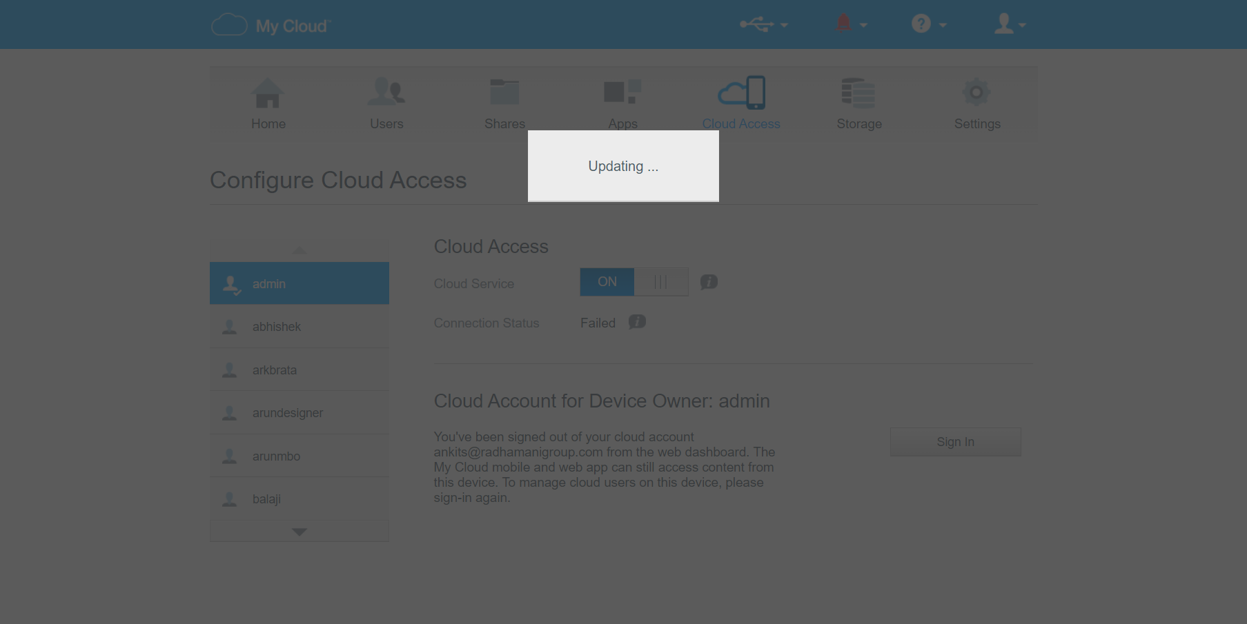

while sign in cloud access its showing updating …

see attach image unable to use cloud access also

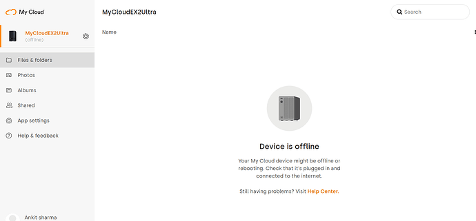

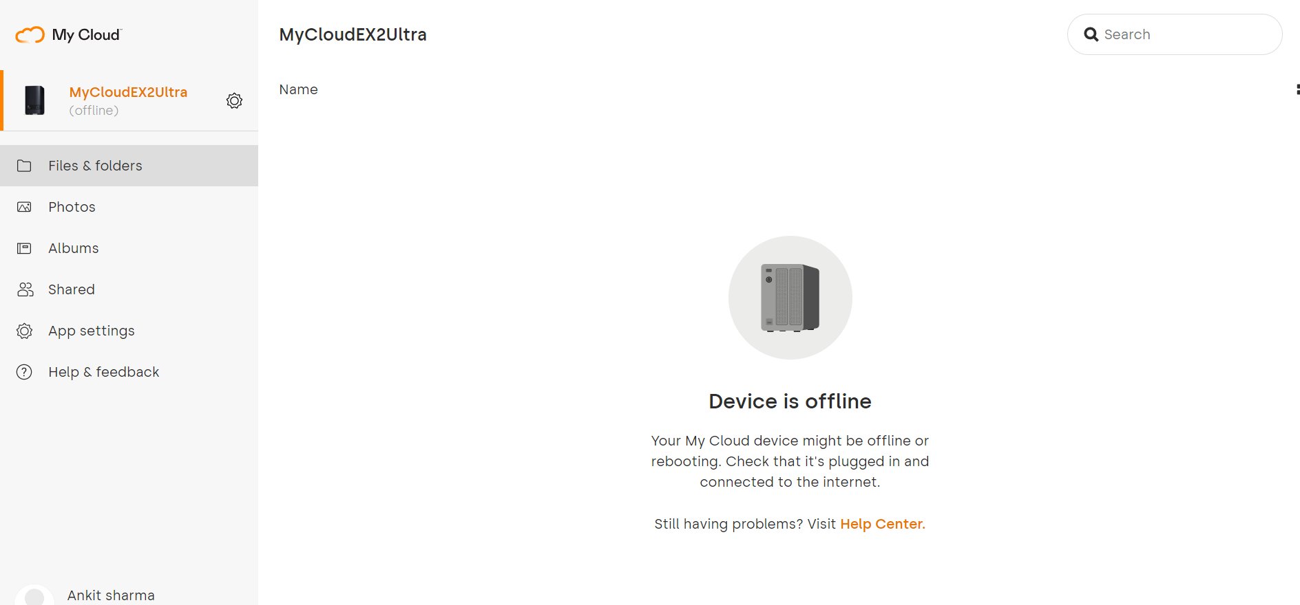

I have the same problem. No access to cloud with WD My Cloud gen2 for several days. Nothing has changed. In the web interface from the local network, on the tab “Configure cloud access” - writes “failure”. I tried off access to the cloud, and now I can’t log in with an administrator account.
If I log in with my account from the page https://os5.mycloud.com/ - the device is offline.

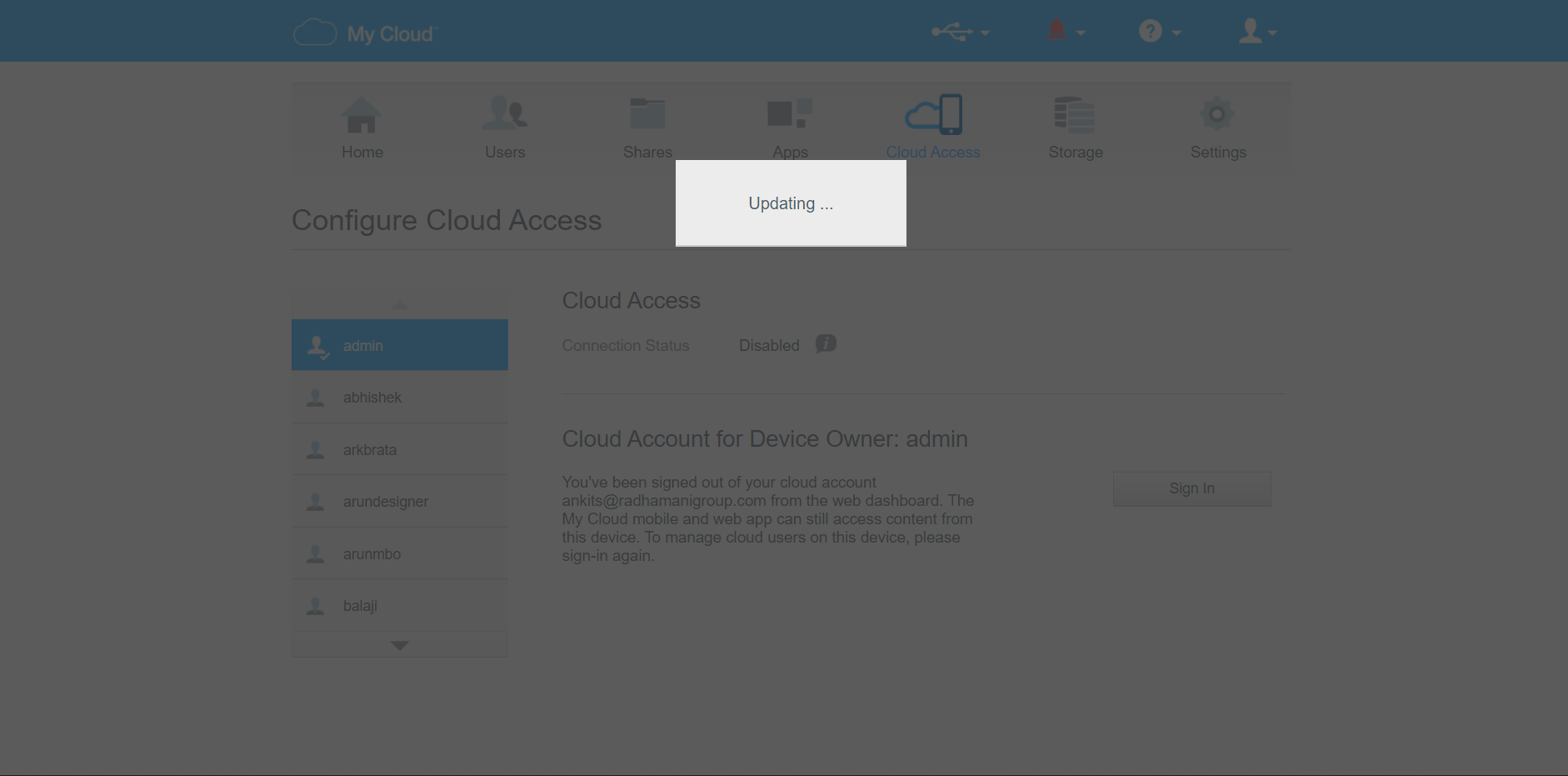

Same issue here… Not able to enable WD Cloud Access showing “Disabled” tried to sign in in using the cloud account id, showing updating but eventually getting timed out. Here is the Incident: 241125-000506
