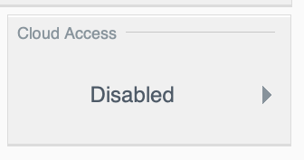

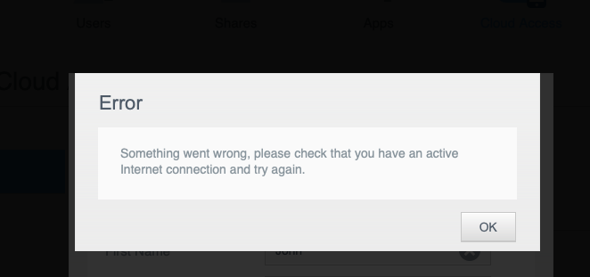

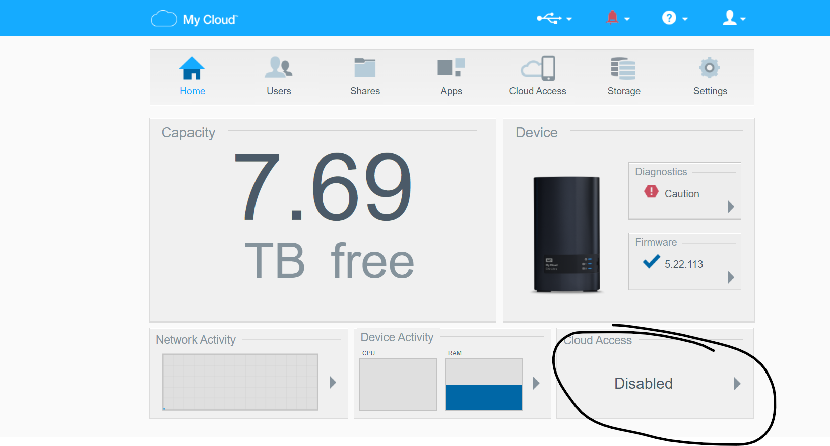

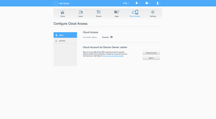

Cloud access is disabled. Trying to create a new account for admin gives this error - “Something went wrong, please check that you have an active Internet connection and try again”.
Shows internet access in network profile.

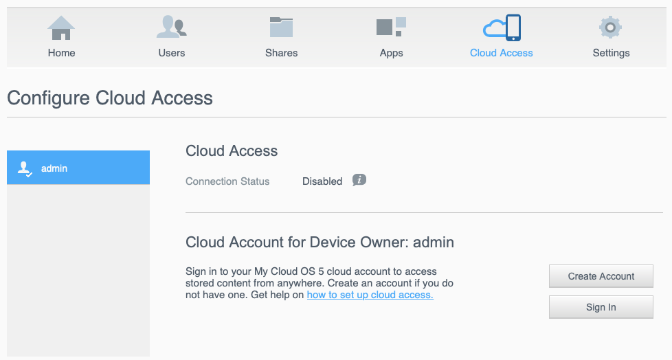

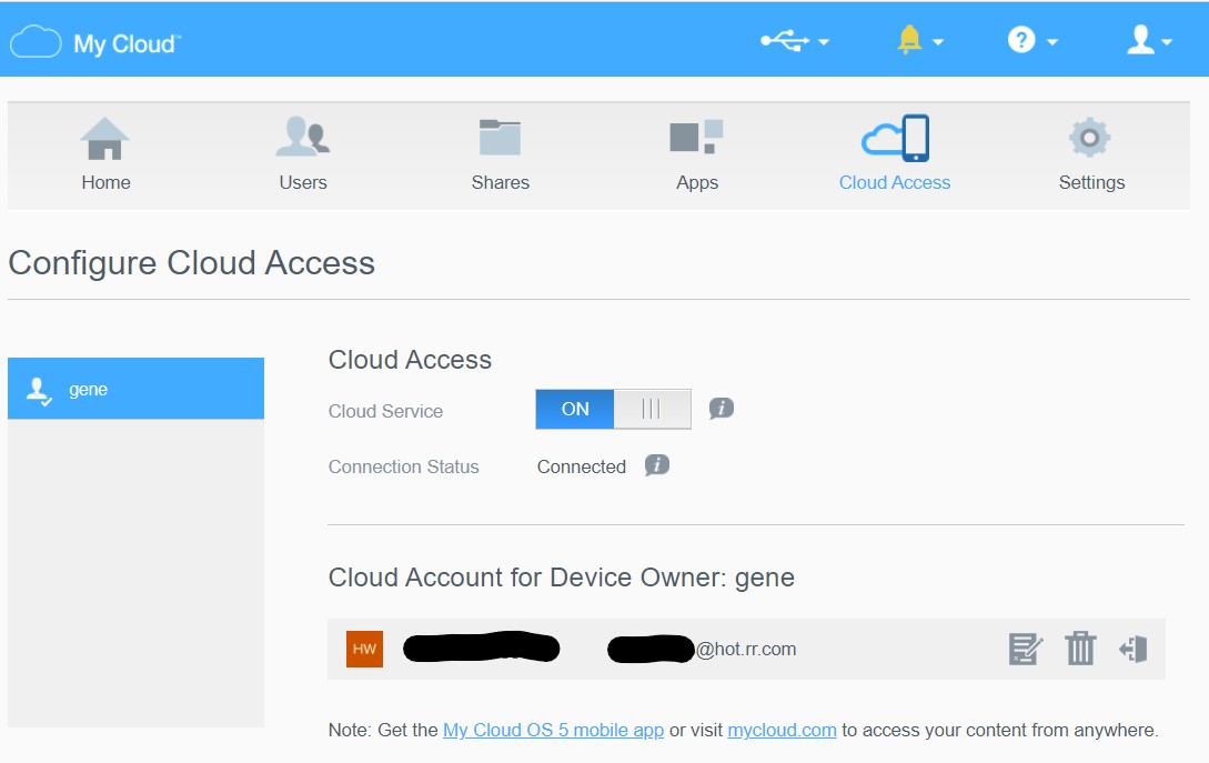

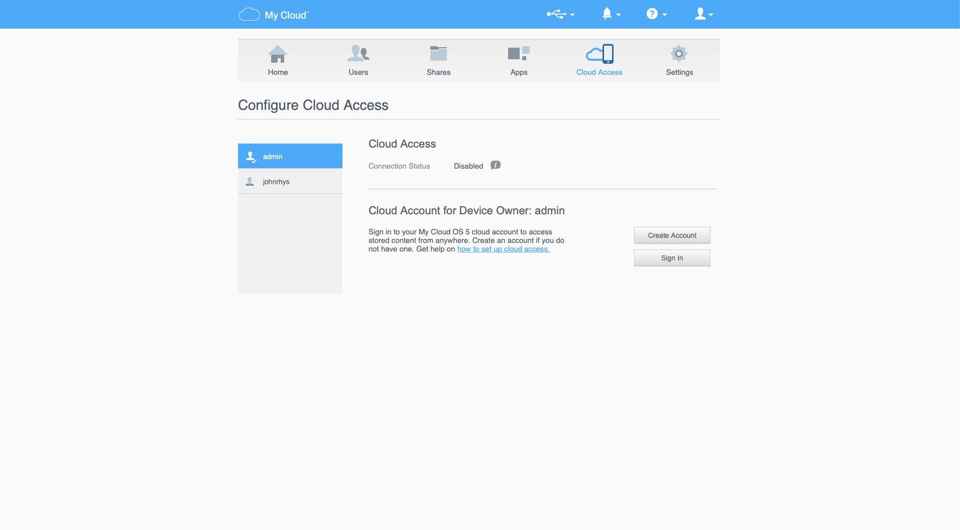

Here is what I have on my 2nd generation My Cloud. The check mark beside my name means I am the admin.
I am the Admin but still, cannot create a cloud account.
Whenever I create an account this message comes up.

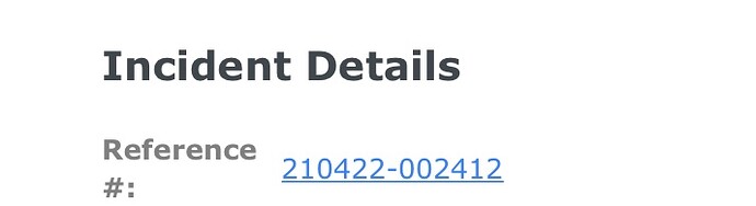

This is the Refrence Number.
Reference # [210422-002412]
The error is on weak authentication password.
Recommend using a stronger password.
2021-04-22T13:55:07.472816+08:00 di=8cwWl0V6XB info adminUI: {“msgid”:“cloud_access_page”,“corid”:“AUI:5c6acdd6-3aaa-47df-a122-68da91a5d2d2”,“function”:“create_cloud_account”,“message”:{“message”:“Admin user failed to create a cloud account.”,“response”:{“name”:“PasswordDictionaryError”,“message”:“Password is too common”,“code”:“invalid_password”,“description”:“Password is not allowed, it might be too common.”,“statusCode”:400}}}

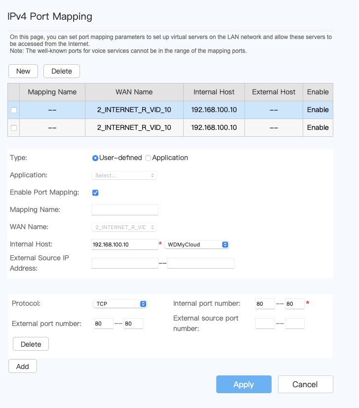

Not sure because I used strong password or because I’d set-up the port forwarding. But finally it worked. Thank you so much :sob:

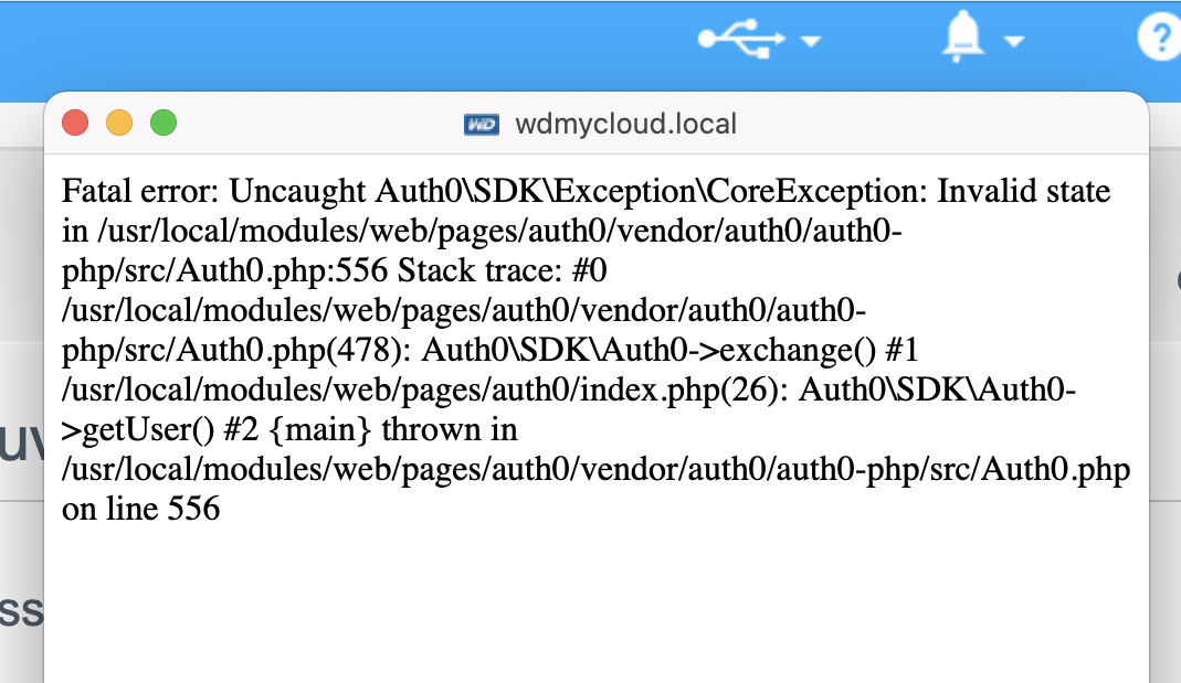

Hello, my problem is the same. I can not enter mycloud account from the nas drive, but my error code seems to be different (as seen in the image).
Please follow the below KBA
My Cloud OS 5: Cloud Access Device Offline
Please follow the “Network Routing Check” one of the servers that your device needs to reach is Auth0
