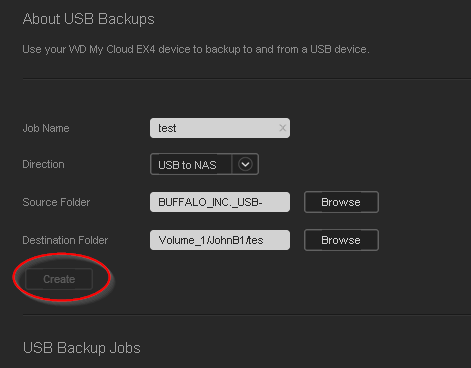

Maybe I should stop the data migration to the NAS and do the network upgrade first so I can achieve some decent transfer rates and get my data safely transferred off these older drives.  In fact, I am going to stop transferring data to the NAS due to the fact that the USB to NAS option on my WD EX4 has decided to stop working all together now (the option to create a backup job has become disabled in the UI).

Yes.  I have tried resetting the device and updating the firmware (again).  This problem still exists after nearly 2 weeks.  I have an open case with WD support but seems that we are chasing other issues and hoping that the disabled feature eventually resolves itself, and it has not.
Unfortunately, I only have another week before I need to return the NAS for a refund within the 30 days.
Note: Create control is disabled below.
I have resolved this issue by deleting all my backup jobs.  I had 10 or more jobs that I had created earlier.  When I first ran into this issue, the first thing I did was delete some of the old jobs, but the create was still disabled.  I decided while out on my bike ride today that when I got home, I would try deleting all the jobs.  That did the job.
