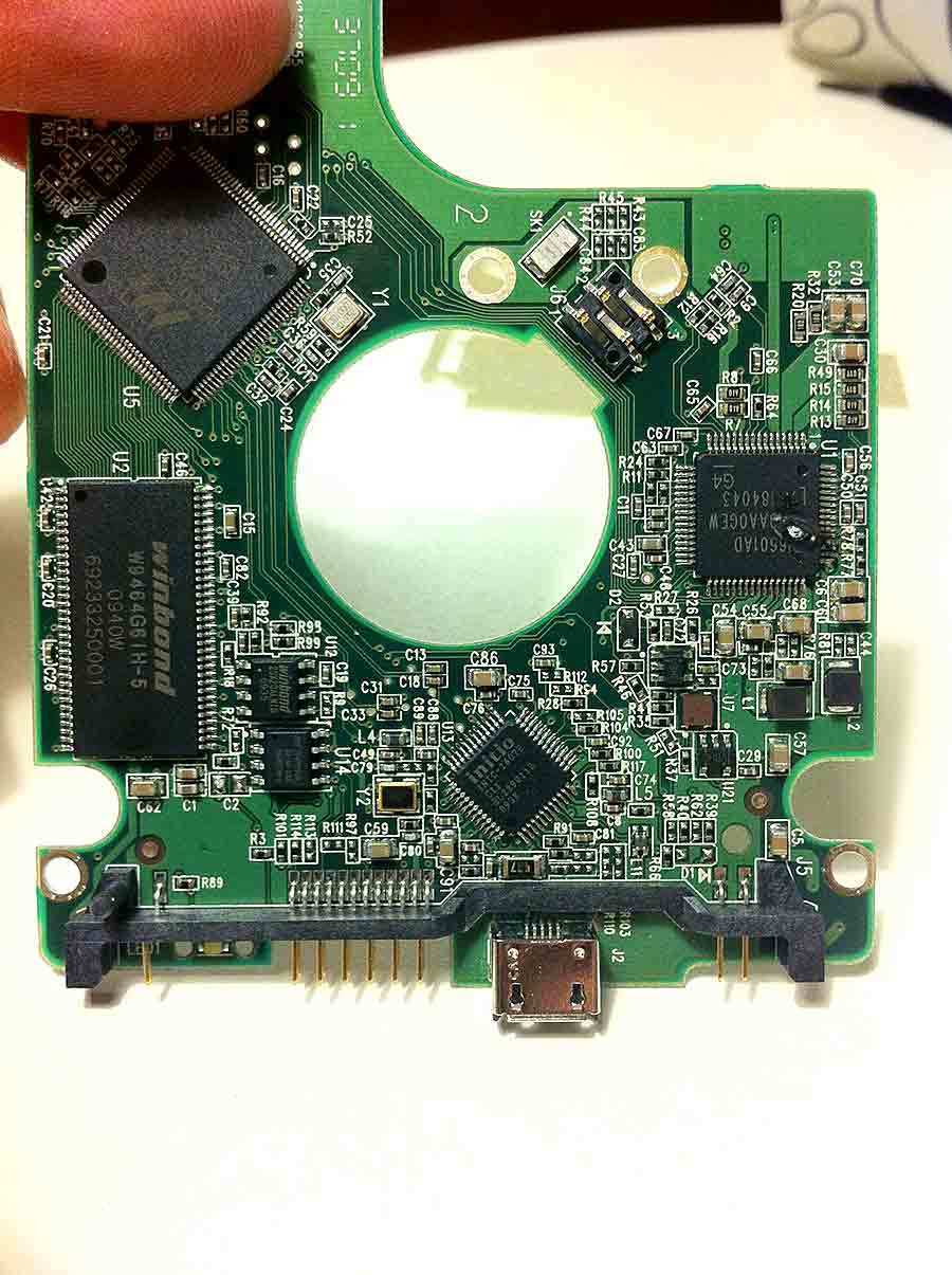

I have a WD Passport drive WD6400BMVV that has a fried component on the PCB. Please see the image below for the exact chip that got fried.

Nothing has worked, so I opened the drive up and found the fried chip. My question now is, is my data lost forever OR can I still retrieve it somehow? Maybe buying a new PNC board and moving some stuff over? I’m no electronics genius, but can follow steps if available.

The burnt chip is the motor controller.
When replacing the PCB, you need to transfer the 8-pin Winbond flash memory IC at location U12 from patient to donor. This chip stores unique, drive specific information. You may or may not need to transfer U14 as well. The latter stores the USB-SATA bridge firmware.
The following PCB suppliers include a free firmware transfer service:
http://www.onepcbsolution.com/
http://www.hdd-parts.com/
The Initio INIC-1607E chip incorporates AES hardware encryption, so if your data are garbled, then U14 would need to be transferred (AFAIK).
If your Passport is an Essentials model, then it will be encrypted. If it’s an Elements, then it won’t be encrypted. In the latter case you may be able to replace the USB PCB with a compatible SATA-only PCB, but you will still need to transfer U12. There are several threads at HDD Guru that discuss suitable SATA PCBs.

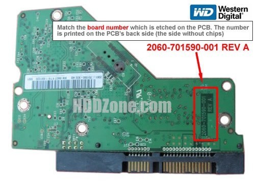

Western Digital Hard Drive PCB Swap Replacement Guide:
Match the  board number  which is etched on the PCB. The number is printed on the PCB’s back side (the side without chips) For example:
When you get this PCB, you need to move your original PCB’s BIOS to the replacement PCB. You can move the BIOS from your original PCB by using hot-air gun, then solder it on the replacement board. Please refer: http://www.datarecoveryunion.com/hard-drive-rom-chip-swapreplacement/.  Or you can find the electronics repair shop to help you
