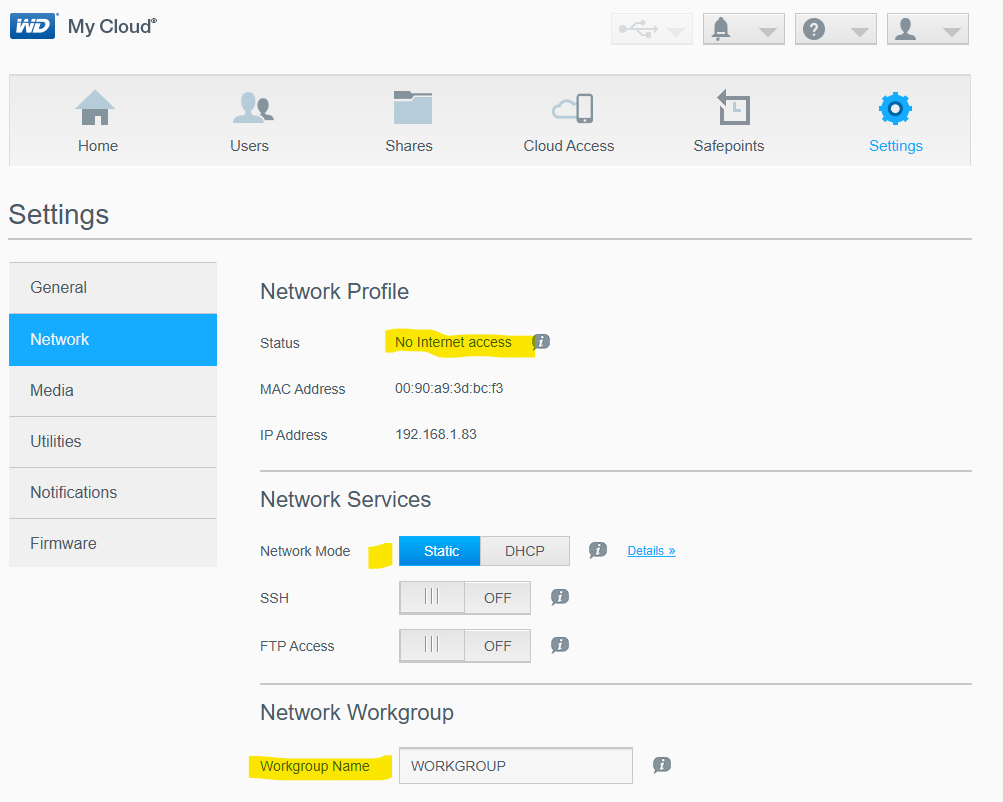

Are you able to get to the Dashboard? If you can, look at Settings and turn off Internet Access. Make the address for your device Static. You should be able to use your device on your home network.

Here are a couple of images showing what you can try. If you remember the name of your shares use them and see what shows.
What \\WD shows
What the full address to a share will show and when you click on it your files should show.
My, My Cloud Ethernet cable is still connected to my router as shown in the User Manual. There is no internet access. My Home network is Private.
