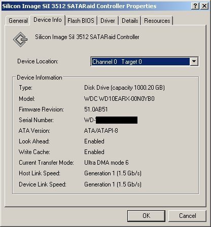

I’m on the computer now. Here’s what Device Manager shows for the controller.  If I understand the dialog box correctly, the drive is communicating at 1.5 Gb/s. To me, that suggests it’s a negotiation issue at bootup, which I’m hoping the jumper will solve. Do you agree?

Yes, according to this WD article on “jumper settings”,
jumper pins 5-6 for 150 MB/second:
http://www.wdc.com/wdproducts/library/other/2579-001037.pdf
But, I don’t generally buy those WD drives,
so I don’t know for sure if this jumper pair
works the same on your drive.
