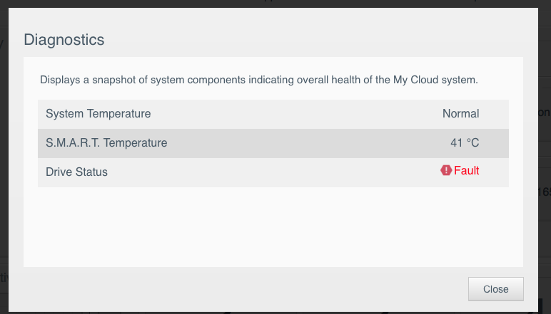

When I login to my WdMyCloud Diagnostics it shows drive status in fault with a red exclamation point but I can up/download data without a problem. Should I be concerned?

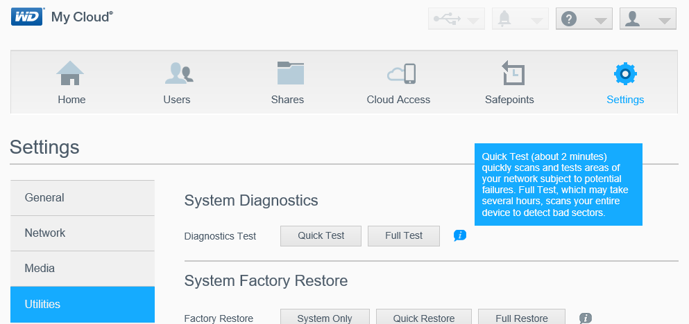

In the Dashboard have you run a full test? See image below. Click on, tap or activate image to enlarge it.
Hello, any update on this? I have the same issue. I already ran the full test but still have the “fault” status. help please. thank you.

One can do what has been previously suggested and perform a system diagnostics test on their My Cloud device. But in the end there are certain errors that cannot be fixed. Hard drives can and do fail. Some will last for many years before failing. Drives can slowly fail over time while continuing to be accessible.

Have you run a system diagnostics test via the My Cloud Dashboard?

My Cloud OS 5: Perform a Quick, Full, or System Test
https://support-en.wd.com/app/answers/detailweb/a_id/14277

I had this a year ago… no details of what’s wrong, nothing under Alerts, no email saying an error, but red light and drive status says FAULT. Ran a full test, nothing comes up, reboot and been fine for a year until just now I have it again.
Not sure what’s more annoying… a vague message with no details… or that there’s a fault but it for some reason triggers no alert or email. Power going out triggers an email and alert and that has nothing to do with the unit at all. Annoying.
Running the full test now… though seems stuck.
EDIT - Full test after 30min didn’t go beyond 10%. Ran a quick test and results were OK. Reboot, and now red light gone and drive status says OK. Seems like if this thing hiccups it pops out an error even though there isn’t one.

Just dealt with this - My Drive 2 had a red light but Drive 1 was Blue. Went to the local device and noted a “Fault” on Drive 2. Ran a Quick Test and everything came back clear. Completed a Reboot. All lights are now Blue and Diagnostics says “Healthy”.
