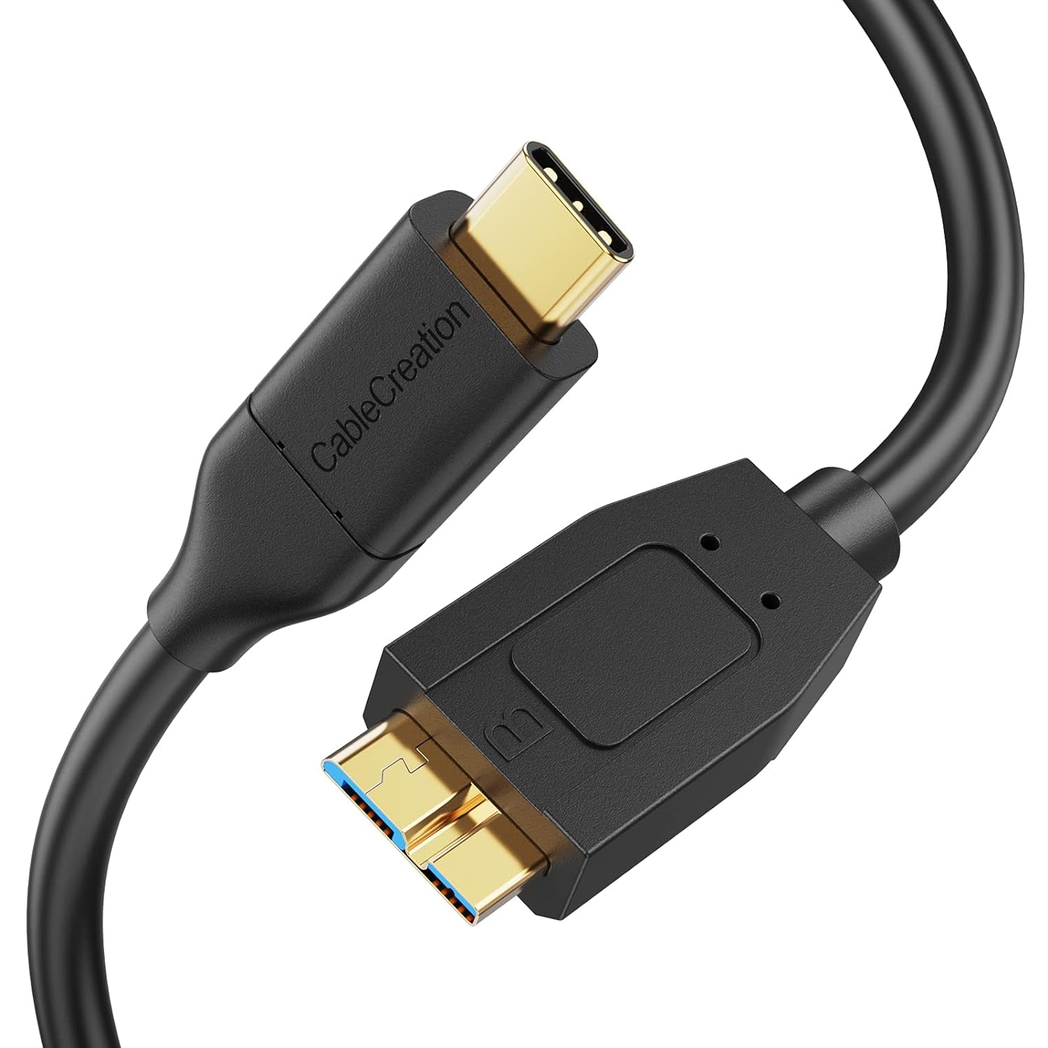

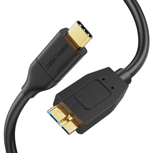

The max read write speeds are no where near those speeds. At most, using a USB C to USB Micro-B cable to the WD Easystore 5TB Drive, I’m only getting around 110 MBp/s - I’m plugging the cable from the WD Drive directly to a 2021 M1 Macbook Pro MAX.
This cable should be able to handle 10Gbp/s speeds so it’s not the cable.
