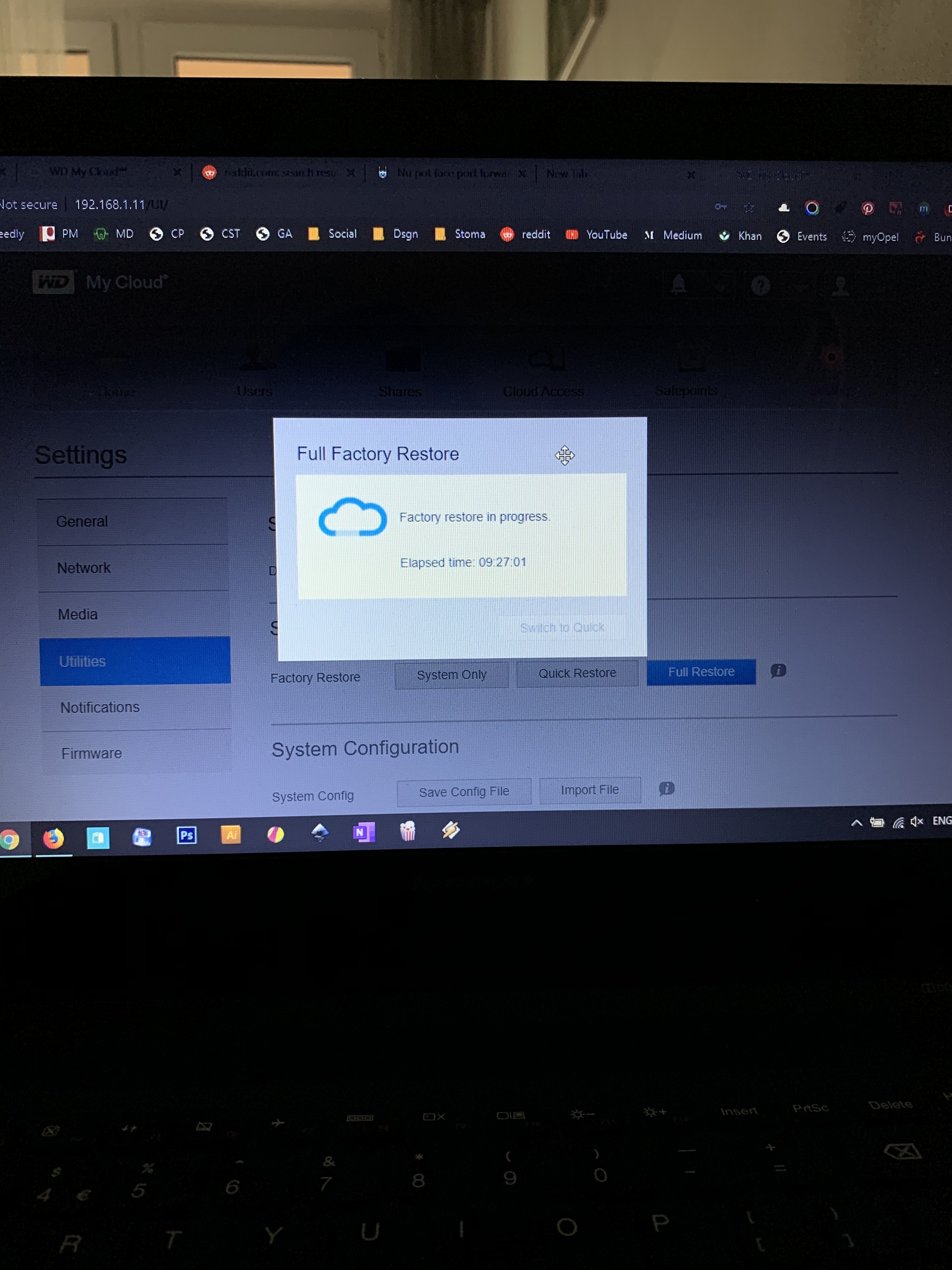

I made the mistake of buying a second hand WD My Cloud and I managed to set it up eventually but I couldn’t make the internet connection work so I decided to start fresh with a factory reset. BIG MISTAKE.
So I waited for 48 hours for the process to pass over the screen with the percentage and now I am staring at the screen in the image for 48 hours.
I have a 4 TB My Cloud. My question is how long do you suppose it will take for it to complete and can I force refresh the page now and not brick it.

You can try that but it may not work. You probably will have to power cycle the My Cloud. Turn it off by pulling the power; Wait a few minutes, then plug power back in.

If the My Cloud is still stuck in the restore process and cannot be accessed with Windows File Explorer or Mac Finder. Your options are; wait for who knows how long for the Factory Restore to finish. Try reloading the Dashboard page if you haven’t tried that already. Or powering off the My Cloud and powering it back on.
So long as the hard drive isn’t defective/dead one can always try to “unbrick” the drive using one of the various unbrick methods. Note that the unbrick process is different for each of the two versions of the single bay My Cloud.
