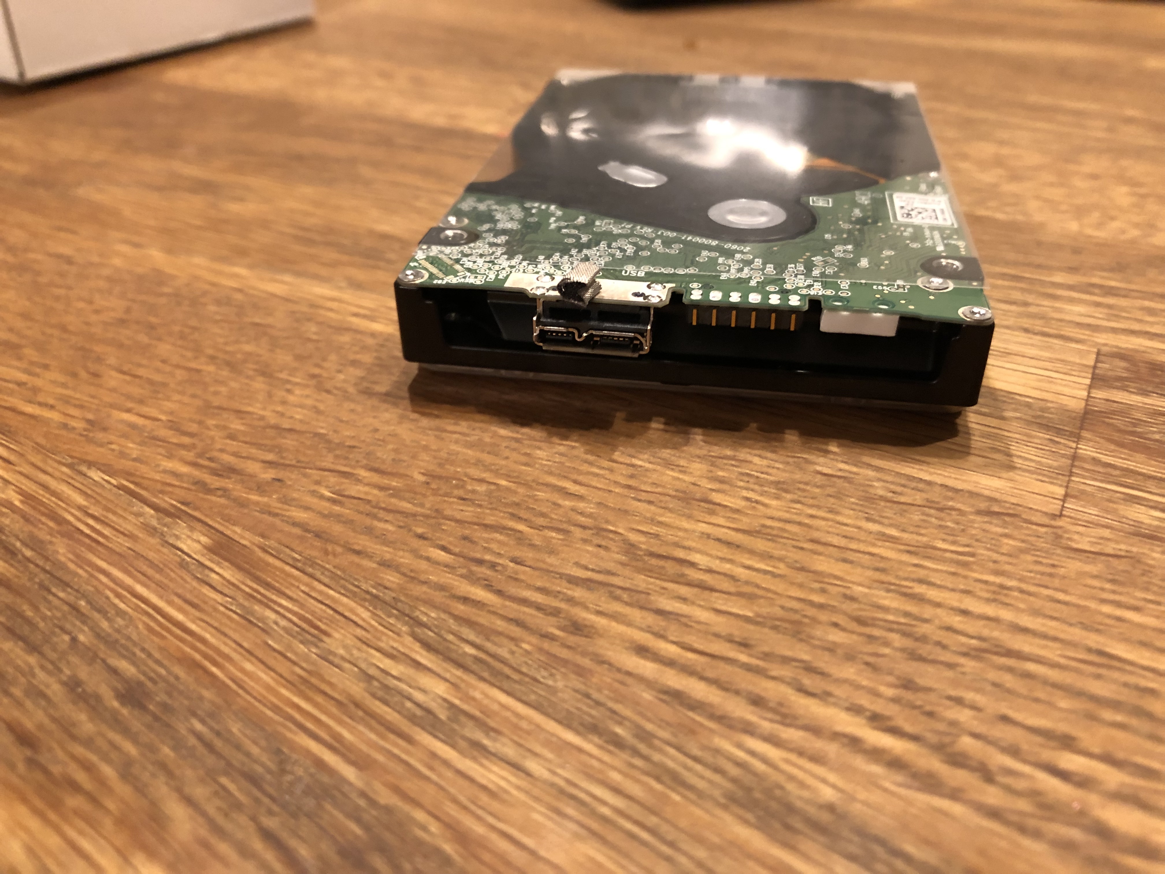

I have the new G Drive Mobile I bought a few months ago with a non-responsive usb board, and it doesn’t have a SATA connection. The piece you’re referring to that should pop out doesn’t exist. It’s all one board screwed directly into the hard drive itself. Not sure if you can see it well in the image. Is there a work-around for this?
The original post was about a older version of the Mobile. This post was from 2017. The newer models of the unit have drives without SATA boards and have a direct USB connection which isn’t possible to work around. Only a data recovery company can proceed.

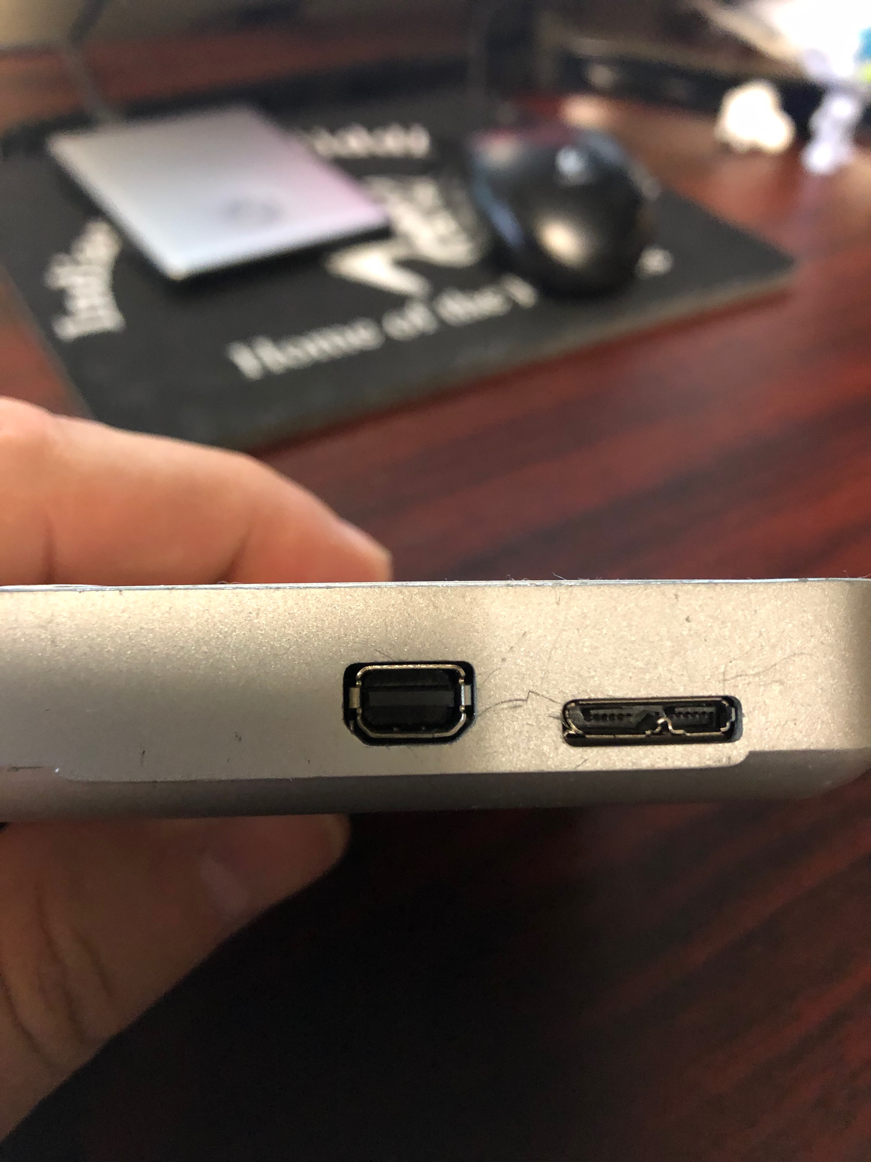

I have an older 1TB drive that works intermittently. As with others in this thread, I believe the issue is a loose connector. However, I wonder if there is an adapter/cable that I can purchase to go from the Thunderbolt port to one of the USB-C ports on my new Macbook Pro? Any help, aside from purchasing a new casing with the same port, would be greatly appreciated.
As you can probably see in the background, I have already replaced this drive, but would like to salvage it if possible.
