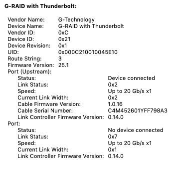

I went to the System Report / System Information > Thunderbolt and see the drive is recognized there. Please advise what I can to mount the drive and access my files again. Thank you.
Attached is a screenshot of the information provided by system information when the drive is connected, but not mounted.
Verify you are using the proper power adapter. What you’re experiencing sounds a lot like it is under-powered. The unit should be attached to a power adapter with ratings of 12v and 4 or 5a.
If you have verified you are using the correct adapter then the issue would be with the enclosure on the unit. If it is still within warranty then you can generate an RMA for the chassis(enclosure) on our site here: RMA Creation
If you create an RMA for this chassis (use the chassis SN, do NOT send drives along, only the empty enclosure and no cables.)
