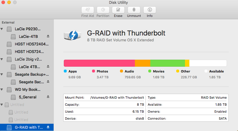

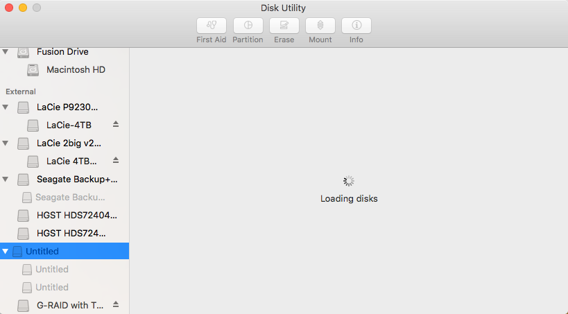

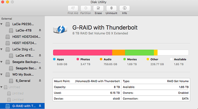

Disk Utility does not see the mounted drive (see screenshot below) - with spinning ‘loading disks’ running continuously

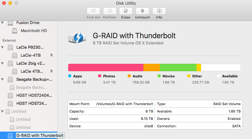

the overall disk seems to be visible (see screenshot below) but this does not let me carry out first aid on the disk

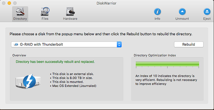

I did click on rebuild button, it was at 8/10 and its now 10/10 see image below.
I’ll try it one more time.
Joe
Just rebuilt again, even tho Disk Warrior said there were no problems. and have the same result.

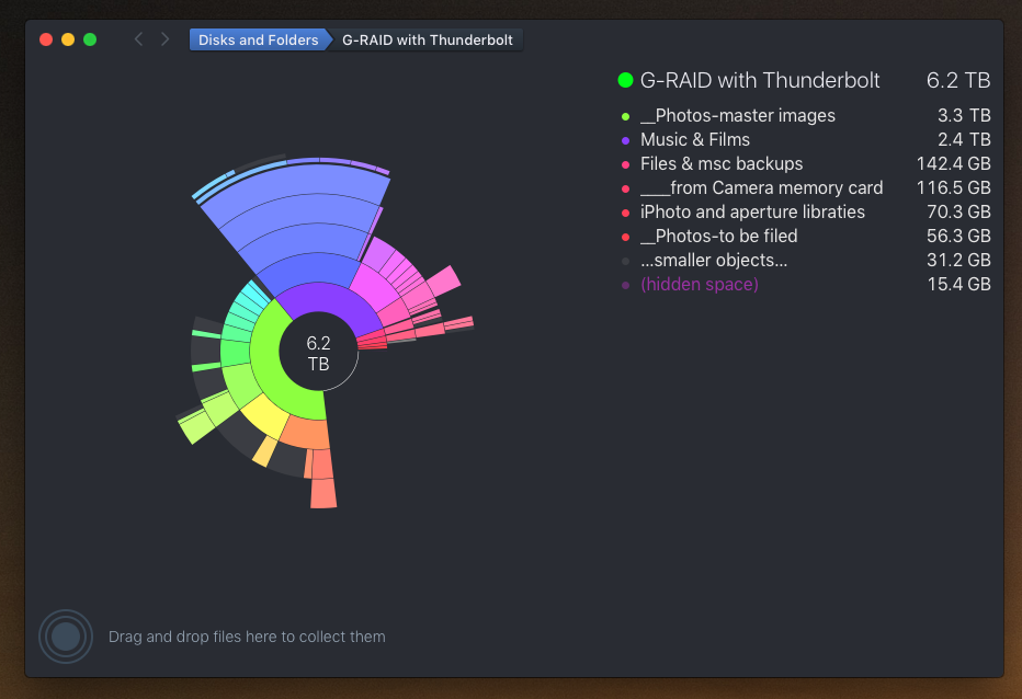

Ran Daisy Disk on and seems fine (see screenshot below)

Because you’re using one of our G-RAID w/ Thunderbolt drives on 10.11 you will have issues in Disk Utility. Apple removed the ability to manage software RAID drives within Disk Utility on 10.11. As long as it is mounting and your other diagnostics are showing OK the device will be fine.

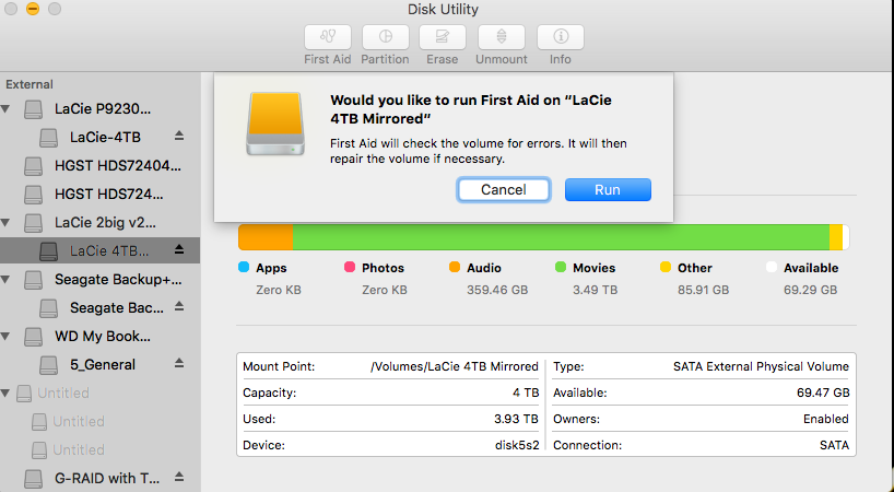

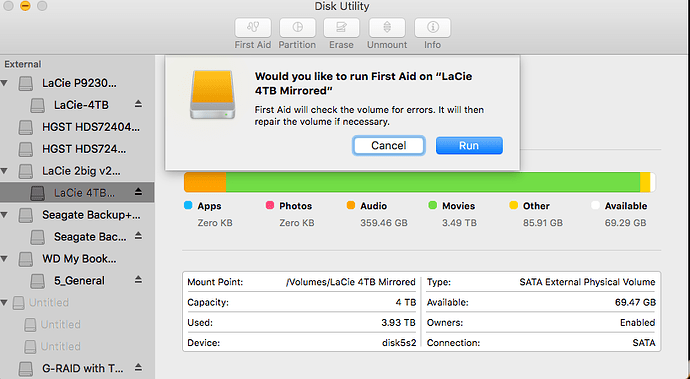

I have another question. I have a La Cie 4tb raid drive configured as Raid 1 for my iTunes library.

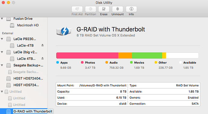

I can see this on Disc utility and can carry out ‘first aid’ see images below. but I can’t on my G-Raid 8? only difference I see is that I’m running this disk as a simple 8TB rather Raid 1 2x4 TB.
Why does OSX see (and can repair) one but not the other?
Joe
G-Raid - first aid greyed out below
LaCie 4TB - can see and use first aid on both aspects of Disk - see below
<img src=“//cdck-file-uploads-global.s3.dualstack.us-west-2.amazonaws.com/wdstagingsplit/original/3X/c/0/c0690a0316a2d7c2cc66d36725920a71b6e07d2d.png” width=“690” height=“380”
Your other drive uses a hardware RAID controller so it is handled by itself not the Disk Utility. Because the version of the G-RAID you have is a software RAID 10.11 can’t manage it. This includes First Aid.
