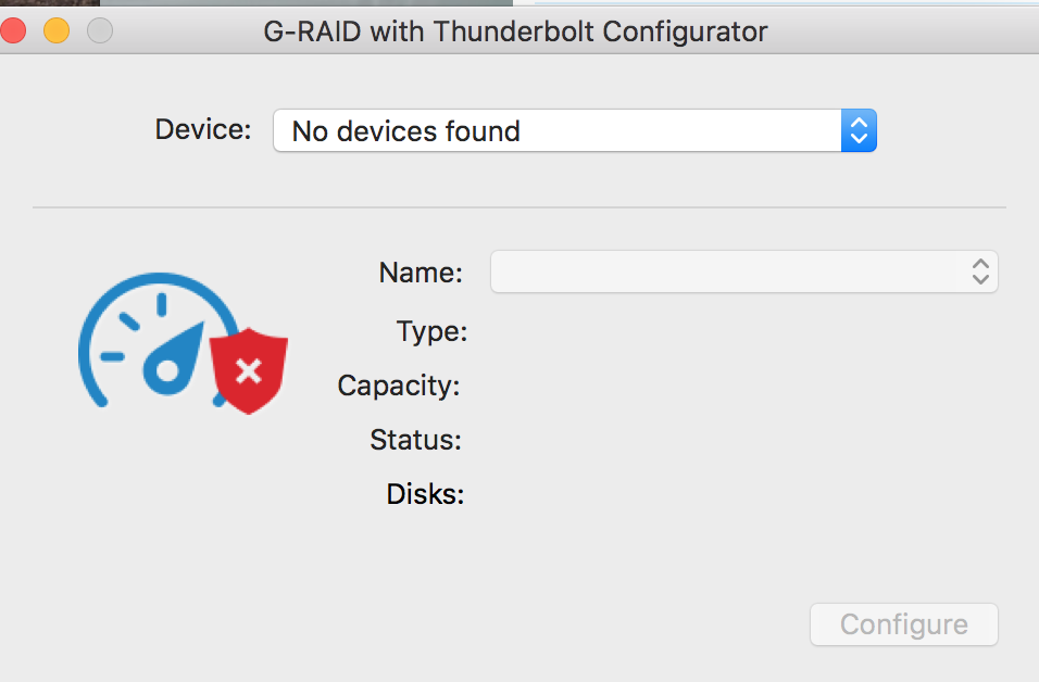

I used G-RAID Configurator. Maybe reason why my G-RAID Studio (Thunderbolt) becomes unreadable after I configure to RAID=1. I’m going to try this…
Joe,
You are using the wrong configurator. Look in the title of your screenshot it is for the G-RAID with Thunderbolt. You have the G-RAID Studio.
Got it. Thank you. ![]()
