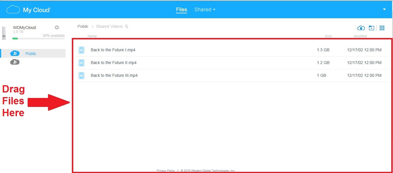

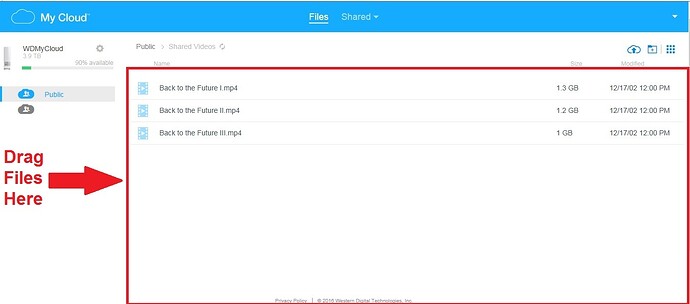

Generally if one wants to move files from their local computer to the My Cloud one can, from their local network:
Drag files using the Mac Finder (or Windows File Explorer) to a My Cloud Share.
Drag files using the Mac Finder (or Windows File Explorer) to a My Cloud Share that has been mapped to the computer.
Or from a remote location:
Drag files using the Mac Finder into the MyCloud.com web portal interface to copy files.
Drag files using the Mac Finder (or Windows File Explorer) into the My Cloud Dashboard program to copy files.

I don’t have a Mac but on Windows one can simply drag from Windows File Explorer into the MyCloud.com window to copy files when one is connected remotely to the My Cloud. Just make sure to be in a Share where you want to copy the files to in the MyCloud.com window.
