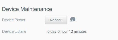

Just purchased a 3TB WD MyCloud and can’t find a way to turn it off. I want to leave it on 24/7 but would like to move it to a different part of the house.
When I got to the settings the only option I have is to reboot.

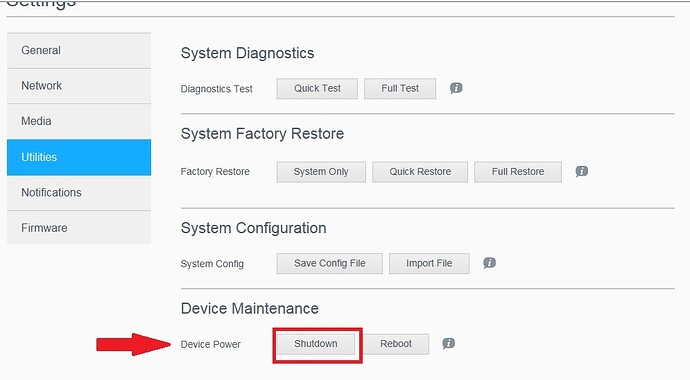

For the v4.x firmware versions there are two locations where there is a Shutdown option in the Dashboard:

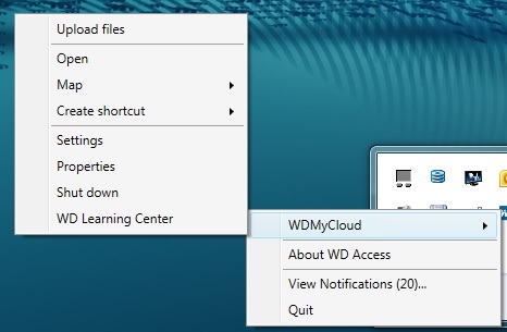

If one is using the WD Access program there is also a shutdown option within that program’s task bar icon.
For the v2.x firmware My Cloud units it appears there is a bug in the firmware and the shutdown option is missing from the Dashboard. There is further discussion on the v2.x problem in the following thread including how the v2.x My Cloud User Manual indicates in two separate places a shutdown button but their graphics don’t actually show it.

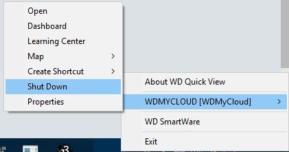

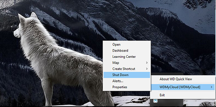

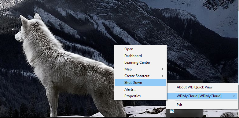

To add to the other ways, one may be able to use Quick View, if they have it, to shutdown their device. See image below.

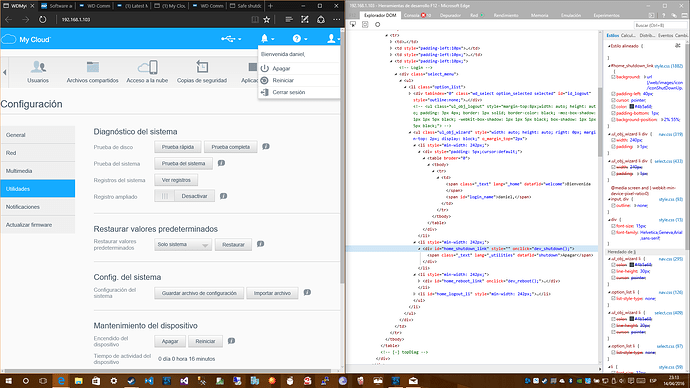

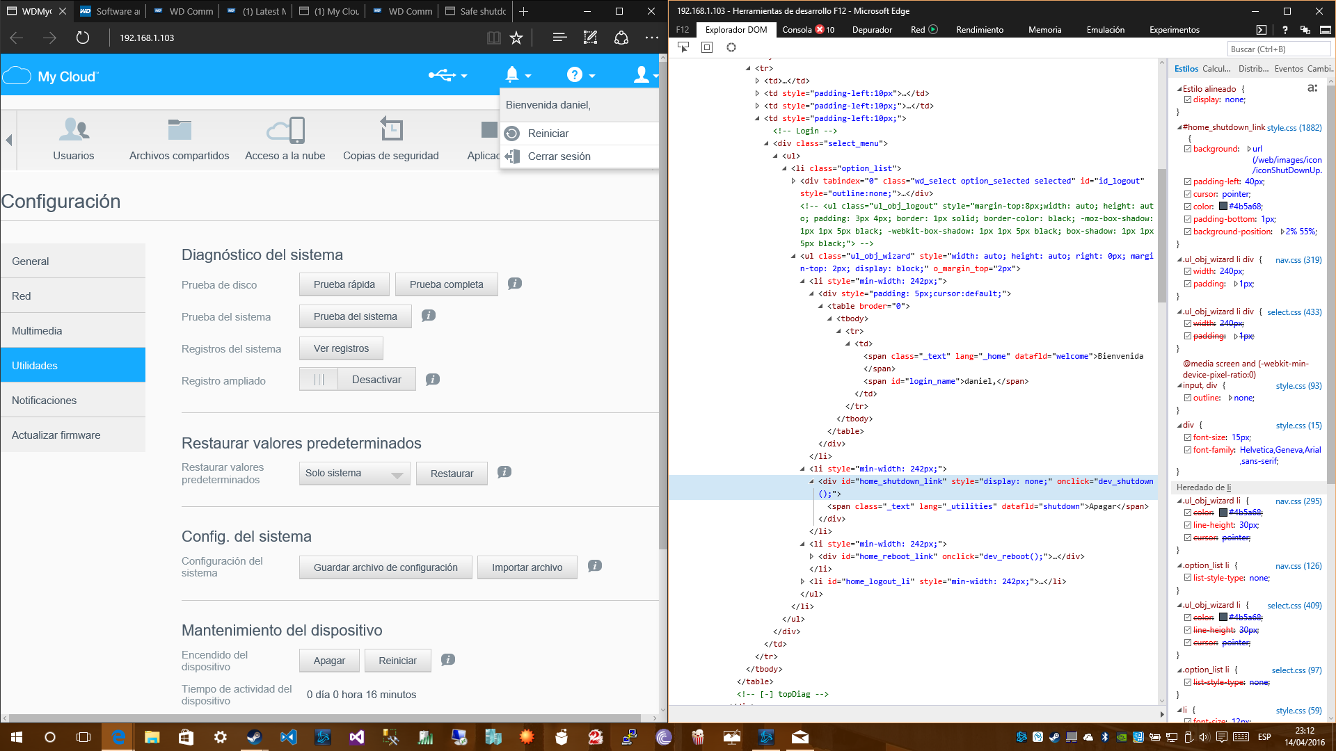

I still found in this forum a partial solution for the correct shutdown. The shutdown button is simply hidden, but with a quick change of the source code it appears.
But I didn’t find the way to save this change. Someone found it?
I share the images I found to explain this partial solution.
Thanks all.
The two version are not compatible with each other as far as firmware and some functionality. Gen1 are firmware 4.xxx and Gen2 are firmware 2.xxx. Gen1 runs Debian Wheezy and Gen2 runs Busybox.
As SectorGZ indicates the two firmware versions, the older gen 1 v3.x/v4.x firmware is not compatible with the newer gen 2 v2.x My Cloud units. WD decision to use v2.x for the gen 2 My Cloud’s has created MUCH confusion among many who think that they have an older My Cloud because the firmware starts with v2.x.
Yes one possible solution to the v2.x missing shutdown button as explained in another thread (http://wdstagingsplit.staged-by-discourse.com/t/safe-shutdown/147307/37) is to use a web browser to change the behind the scene’s coding (CSS) for the page. Problem, as you found, is the change does not persist once made. If the page reloads the button reverts to being hidden. One could attempt to change the CSS coding within the firmware using SSH, which would most likely fix the issue and allow the button visibility to be persistent when the page is loaded or reloaded.

As explained upthread and in numerous other discussion on the lack of the Dashboard shutdown in v2.x firmware for the single bay My Cloud units one can use (I think) WD Quick View (https://support.wdc.com/product.aspx?ID=904#WD_downloads) to shut down a v2.x single bay My Cloud. One can apparently also use SSH to issue the shutdown command to the v2.x version and can use a web browser hack of the My Cloud Dashboard to shut down the v2.x version.

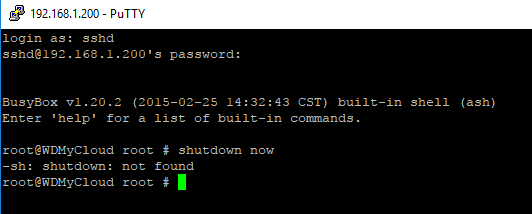

Yeah, how about that shutdown command … on version 2.x firmware.
One CANNOT apparently use SSH to run the shutdown command on 2.x firmware.
This is the only official (no hack) way to perform a proper shutdown:
https://support.wdc.com/downloads.aspx?p=188
Download and install WD Quick View using the above link.

Correct. As previously mentioned up thread using WD Quick View is the current way to shut down a v2.x single bay My Cloud unit. WD even has a Knowledgebase article covering how to shut down the single bay My Cloud models.
There is much confusion on shutting down the single bay My Cloud units due to the different methods to shut down the first gen v4.x My Cloud and the second gen v2.x My Cloud. The v2.x single bay My Cloud no longer has a shutdown (or hibernate) option in the My Cloud Dashboard. And while the v4.x My Cloud can be shut down using WD Access, the v2.x My Cloud can be shut down using WD Quick View. Then there is the issue that the two My Cloud models use different firmware which means the SSH commands to shut down the older v4.x My Cloud does not work on the newer v2.x My Clouds.

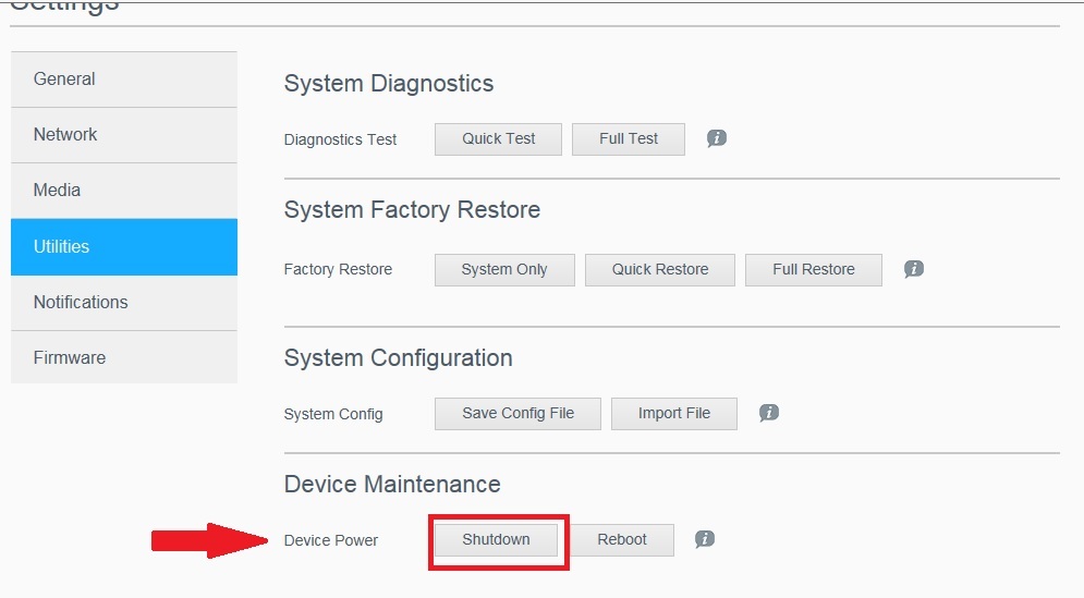

Incorrect, and I showed visual proof that the shutdown command is not even available on the 2.x firmware.
There is much circular logic discussion with people pointing to other people saying other people are doing it, yet not confirming the actual firmware version. People with 4.x firmware can do it, but not those with 2.x firmware.
Again, the people saying it can be done are only those with 4.x firmware.
Let’s stop the rumors and check the facts. I showed above that the shutdown command is not even available on the 2.x firmware single drive My Cloud.
Why Western Digital left out the shutdown option from the GUI is the question/concern here though.
BusyBox does not even have the command:
