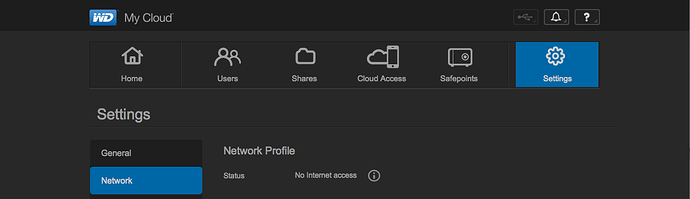

This is my problem. It says I have no internet access. And the internet is working in my house.

I can’t check for updates or anything because it doesn’t believe that it is connected to the internet.

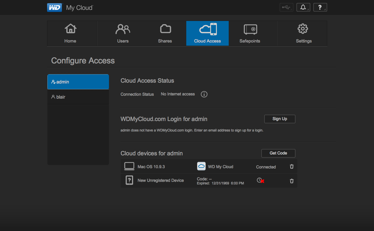

I cannot turn on cloud access, because I do not have that option. My Admin use on the Cloud Access screen looks like this…
The Connection Status is what I am talking about, and the “New Unregistered Device” is interesting, and I am unable to remove it. Whenever I try to adjust anything, I get errors.

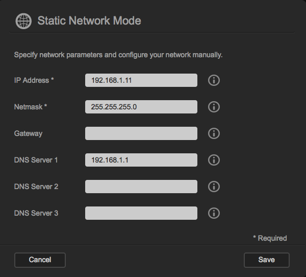

The settings that I have for the Static Network Mode are shown below. The IP address from the router, and the DNS Server 1 is the IP address of the router on the network.

Now that I can see your screens the gateway need to be set to 192.168.1.1, without a gateway set the MC can’t see past your LAN.
and the DNS depends if your router is providing DNS services, some do, not all. check what your PC is using for DNS and match that or sign into you router and see what it has for DNS and set it to that. even if your router provides DNS it will not hurt to use the address from your provider
